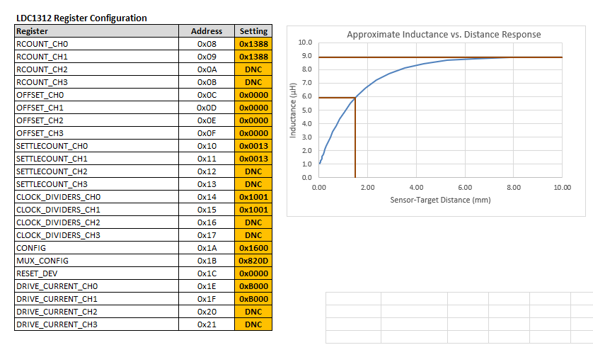

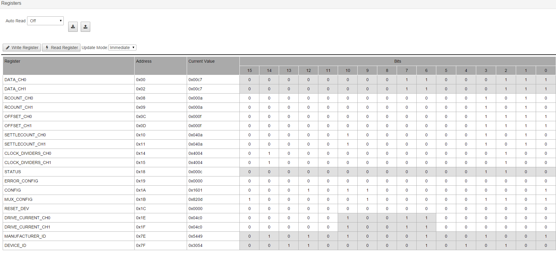

So I tested this sensor response on its EVM, and got quite poor results – it works, but only at very close range, we can distinguish significant delta at both channel 0, and channel1 readings.
See the most optimal configuration I reached + data offset which is read when there is no metal target:
I only reached it by try and error , and have no technical explanation of why those parameters are the most sensitive ones. I still can detect a target from a very short distance – well below 1 cm (then the readings are ~ 0x3ff – 0x3d), overwise readings delta is no more than 3-4 LSB.
We are using external OSC of 40 Mhz, as an EVB onboard option.
Can you suggest a more proper configuration for metal presence detection or maybe some HW changes? I tried to review online design notes and calculators but did not succeed to reach any conclusion, suitable for my use case.

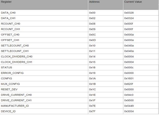

I also reached additional configurations that seem to be sensitive enough, but still cannot understand the theory behind those settings.
Those are recommended settings from a design spreadsheet, but with those settings, it responds to target is not optimal:
Should I run the FEMM tool instead? I’m using the coils design that exists on EVM, did not change nothing in HW.
Can you please advise what are the optimal parameters for this coils design and why?

  • Hello Shai,
    Both the coil size and the target properties will affect your maximum sensing distance. In general, for a good target, the maximum sensing range for the LDC devices is ~50% of the sensor coil's diameter. To detect metal several centimeters away the sensor coil would need to be much larger than the coil on the EVM. The LDC161x is our most sensitive device, and it can detect metal targets at distances up to 200% of the sensor coil's diameter.
    For more information about the sensing range and how target and sensor properties affect that, I highly recommend reading the FAQ below. LDC Sensor Design and LDC Target Design are great places to start. For information about optimizing register settings and achievable resolution for various settings, please see this app note: http://www.ti.com/lit/an/snoa945/snoa945.pdf
