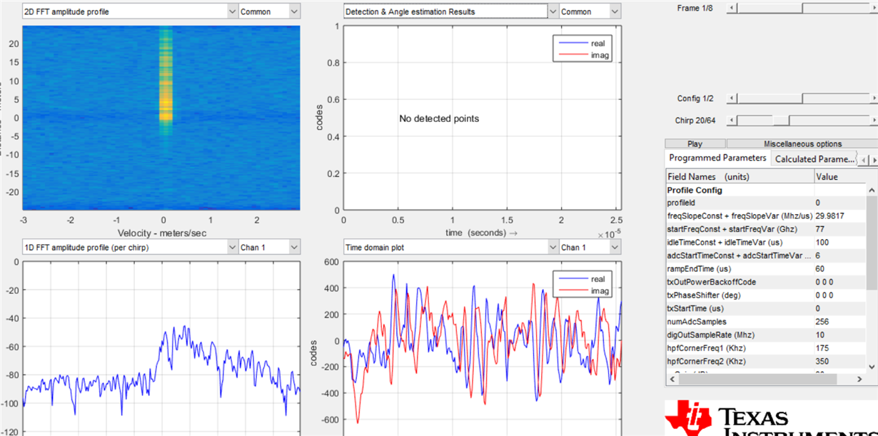

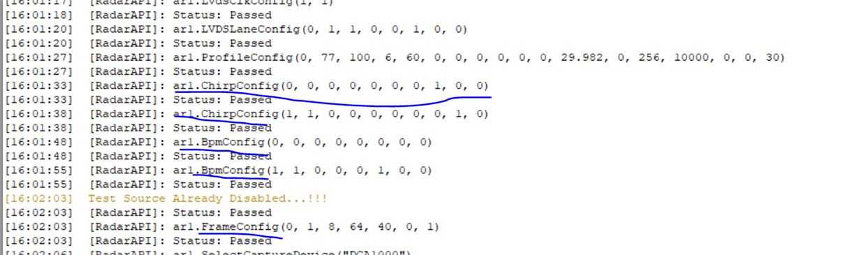

    Another questions. I tried to configure the BPM mode. 2 TX, 4 RX. some script as follow. How can I know if the configuration is right or not?
    I just got an update from the team that in the Studio PostProc it doesn't support BPM feature.
    You need to do it by your own Matlab script to remove the BPM codes while processing for specific chirp data.
    Jitendra

    Last question. For 2 TX, which configuration determines whether the two antennas are sent at the same time or alternately?
    I configure 2 chirps and 2  Tx. TX0 with Chirp 0, TX1 with Chirp 1.
    With my own matlab code, I see that  the 2 TX work alternately. that is a TDM mode. So how can I configure 2 TX work at the same time?
    Thanks a lot.
    To use 2 Tx together you need to configure that chirp config with both of Tx checkbox selected. chirp0 with Tx0 and Tx1 selected, then both of Tx are used while chirping chirp0.
