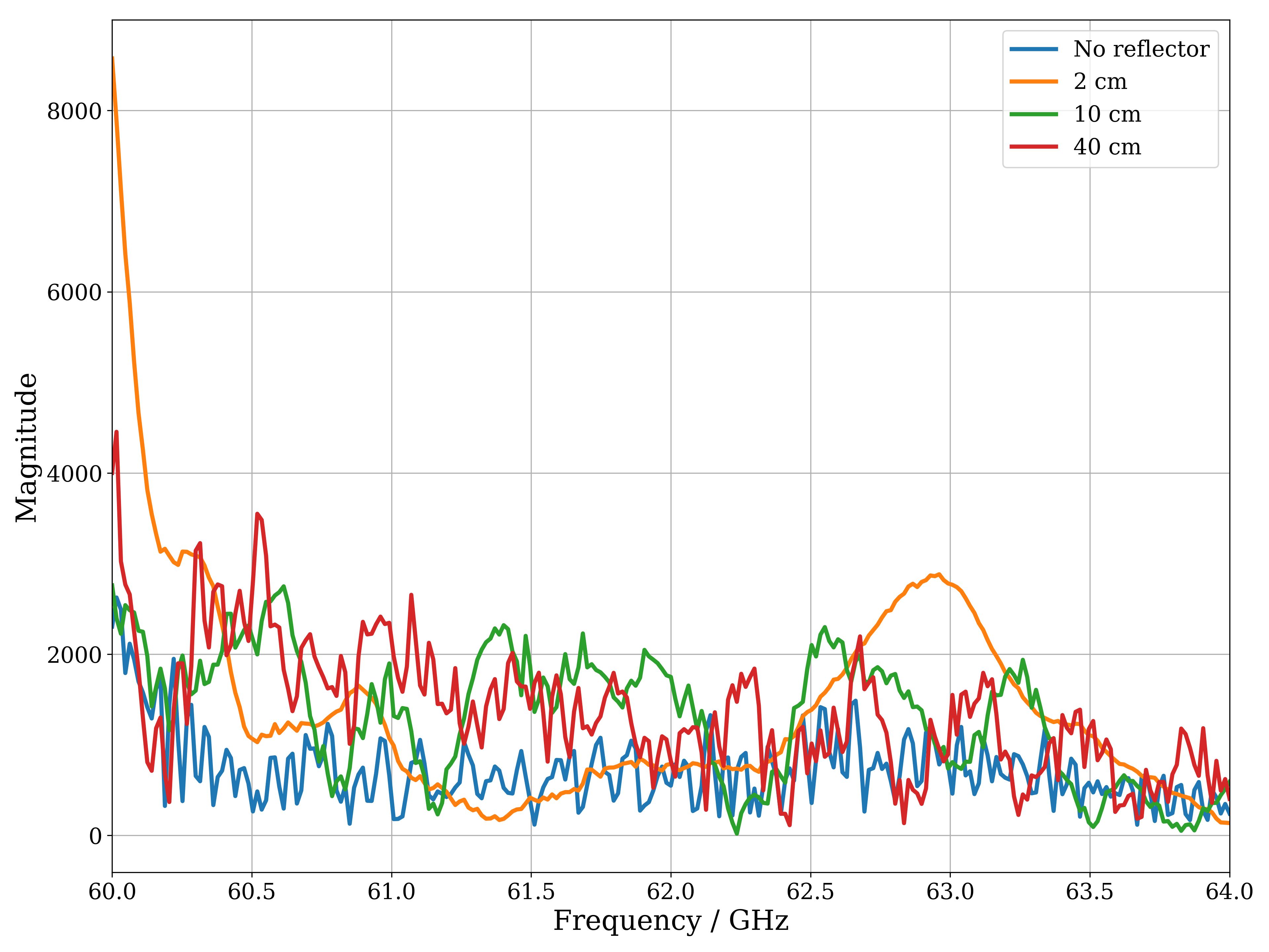

We are capturing the raw ADC data from the IWR6843AOPEVM. Without any objects present the magnitude of the signal is much the same as when there is a reflector close to the sensor.
Do the receiver channels have AGC and if so, can we turn it off?
Another contributor asked the same question for the AWR1642 and he was told there was no AGC, but his case didn't provide a solution to his problem.

  • Hi Chethan,
    The graph below shows the magnitude of the received signal on Rx0 for a chirp, averaged the data over 100 frames, with a 10cm x 10cm copper pcb reflector placed at varying distance from the IWR6843AOPEVM.
    We don't understand why the magnitude is not varying with the reflector distance, if there isn't any gain normalization going on. We would be grateful if you could explain it and suggest how to make the received magnitude vary with distance.
    The mmWave configuration was obtained from the mmWave Demo Visualiser, using the default settings but with only Tx0 enabled and with the frame rate set to 1 frame/s.
    We are reading a single chirp of Raw ADC Data straight from the start of the Raw ADC buffer and outputting it to the serial port immediately after the default processed data (we're not using a DVM1000).
    Otherwise the firmware is the OOB demo.

  • Ian,
        For the above chirp configuration range resolution is 4.4cm.
    For such close distance (2cm and 10cm), leakage from Tx to Rx would dominate in terms of reflected power as compared to power reflected from the metal plate. Typically this may spill over few range bins. Object 2cm/10cm falls in DC and few range bins would be suppressed by Tx, Rx leakage.
    Typically, for reference and calibrations  Corner reflectors are used (For example shown below), This will have known RCS for calibration as compared to metal from PCB reflector. https://www.miwv.com/trihedral-corner-reflectors/
    You could try higher distance with the stronger reflector to see reflected image higher from noise floor. Also you could use more chirps/frame to increase the SNR and reduce the noise floor.
