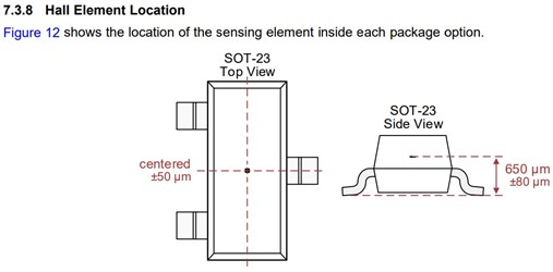

Hi Team,
The section 7.3.8 tells the hall element location, could you please double confirm if the sensing element location is in the center? Because the application need high resolution so that the sensing location is very important.
Thanks and Best Regards!
Hao
  • Hello Hao,
    Yes, the datasheet shows the correct values for the Hall element location within the package.  This means that from the top view the Hall element is centered ±50µm and from the side view the Hall element is 650µm above the lowest point of the package/pins ±80µm.
