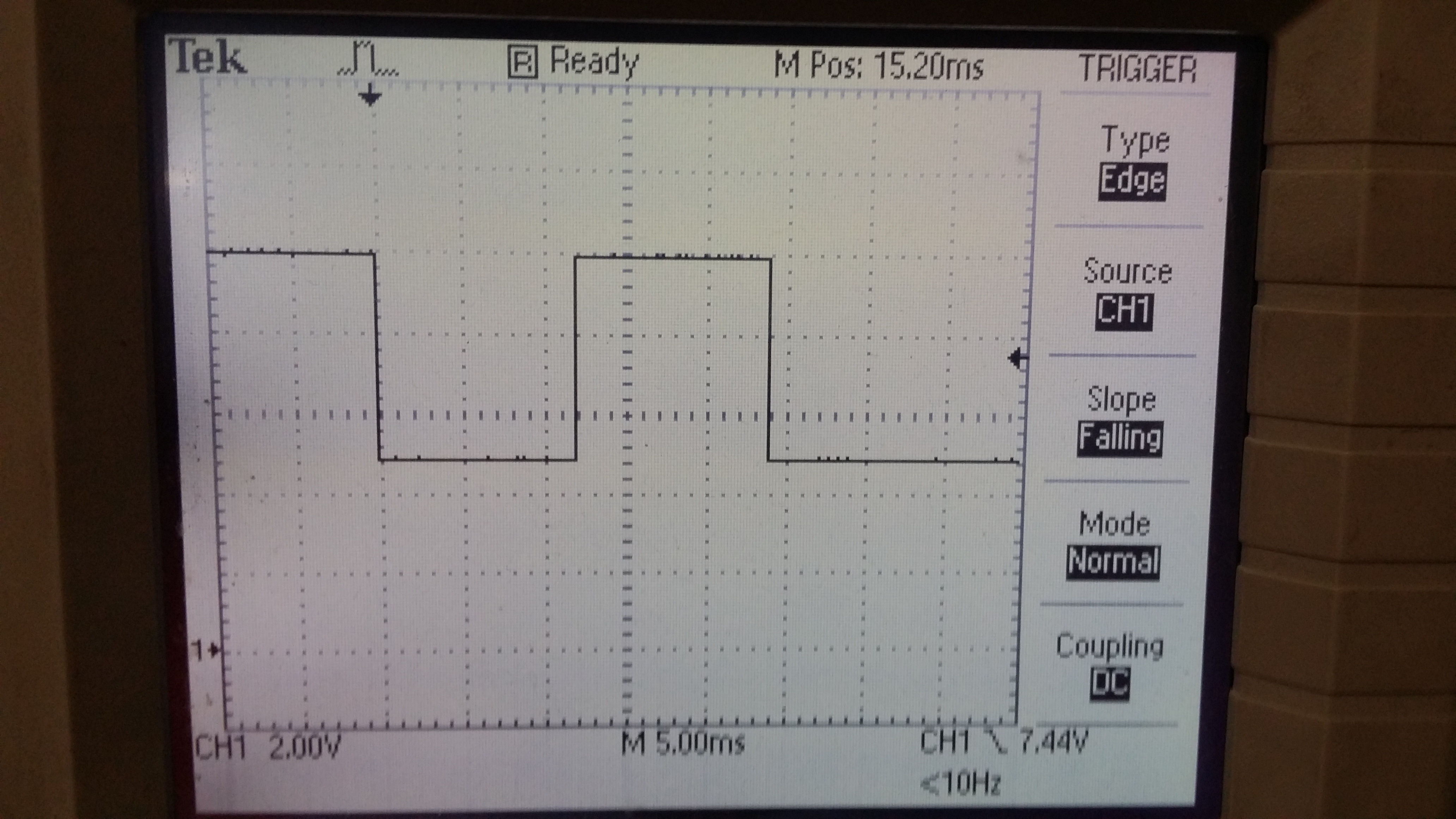

We are having problems with the PGA900. We can't connect OWI. All are doing everything according to the description, but no entrance to the interruption of OWI.

The food is served momentum as in the description, the waveform I enclose in the attachment. Don't understand where is the error.
Can you help?
Oscillogram on VDD
    Just to clarify, you're certain that the OWI interrupt service routine is not being entered?
    If the program is not entering the interrupt then either the activation pulse is not being recognized and the interrupt is not generated at all, the interrupt is not enabled/configured properly.
    The waveform you have shown for the OWI activation pulse looks good, but have you tried setting the deglitch time to 1ms instead of 10ms?
