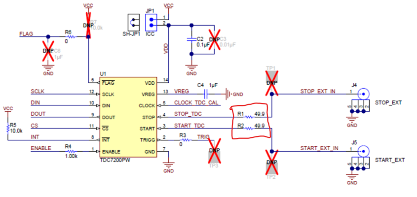

Hi TI team
could you explain why you put these two 50 ohm resistors on the receiver side?
Is it not better to use parallel termination in this case?
Best regards

Hi Daniel,
The in-line resistance acts as part of a low-pass filter given the input capacitance is 3pF at the START and STOP pins. This is to prevent false-positives otherwise created by high-frequency transients-glitches at these pins.
