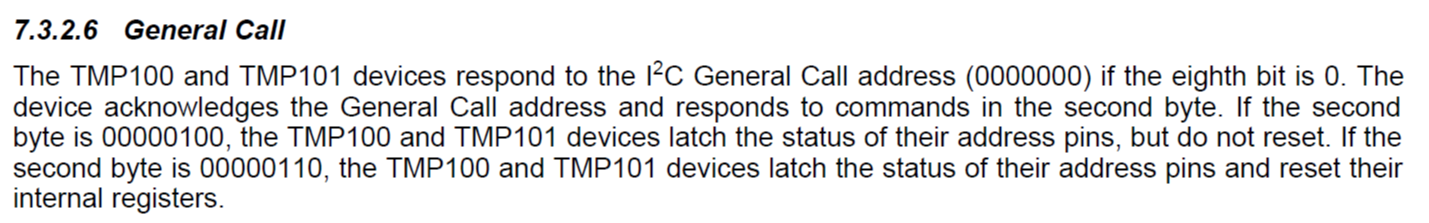

In datasheet, it mentioned about the General Call. What it means by "latch the status of their address pins"? And can we use the second byte of 00000110 to reset the device?

    I2C was not really designed for hot-swappable communication. On connection, you are changing the bus capacitance in real time, and SDA and SCL are very likely to be effected by noise or transients. This could be leaving the TMP100 in an unknown state. If you attempt a general call reset during one of these stuck conditions, does it correct the device being stuck?
    In order to function consistently, you should consider using a two-wire hot-swappable buffer such as the TCA9511A. This will resolve the electrical and timing problems of hot-swapping with I2C.
