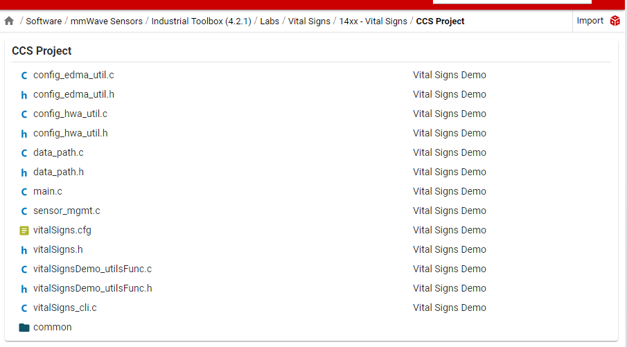

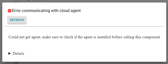

I am attempting to import a CCS Project (14xx - Vital Signs) via Code Composer Studio and I continuously get the "Error communicating with cloud agent - Could not get agent, make sure to check if the agent is installed before calling this component".  I have most certainly downloaded the agent and attempted to install several times.  The installation process seems to go smoothly, no errors.  I am administrator on this Win7, 64-bit machine.  Furthermore, if I launch https://dev.ti.com/, I am prompted to install the Cloud Agent.  Still, not detected.  I have tried this in both Chrome and Firefox; I have confirmed the browser plugins to be successfully installed.  Per the troubleshooting page, I have enabled what appears to be every logging feature within ticloudagent.bat:

Yet there are no logs whatsoever appearing in c:/temp.  The batch file is not being invoked by either CCS or the browser (I suspect it should if this is intended to produce log files at agent startup).  I have closed everything out.  Restarted everything, including the machine.  All the same results.

  • Thanks for your response, Nitin.  I am using CCS v. 10.0.0.00010.  It appears, from my research anyway, previous versions of CCS allowed you to simply download the project in the form of a zip file, then import it manually into the IDE.  It was easy and intuitive.  This newer version replaces that download button with an "Import" button, which in turn is intended to trigger the cloud agent.  Each time I click that, I get this error.

  • Hi Christopher,
    We have not tested our Industrial toolbox projects with versions beyond CCSv8 which is why we specifically mention CCS 8.3 in our project software requirements. That being said, you should still be able to download the Industrial Toolbox as a zip file through Resource explorer in a browser as explained on this page
    http://dev.ti.com/tirex/explore/node?node=AOeX-yPbUcqy5W0kmizXEQ__VLyFKFf__LATEST (Refer section: "Via Web Browser")
    and import the project by searching it in the file-system as compared to one click import through Resource explorer inside CCS.
    For the specific issue related to CCS Cloud agent, and it's need there-of, I would suggest creating a ticket in the CCS forum (you can refer to this ticket for context).
