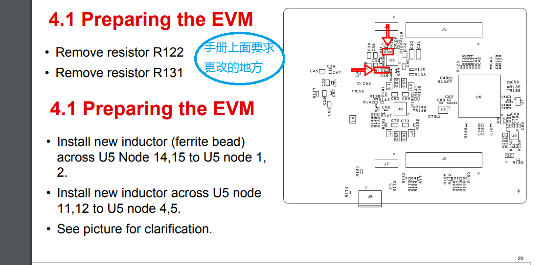

I am using the TIDEP-0091 kit, but I can not run it well now - I have not programmed IWR1443EVM and MSP432EVM boards yet. as says in manual "level_sensing_gsg.pdf",there are some hardware changes on  both boards.

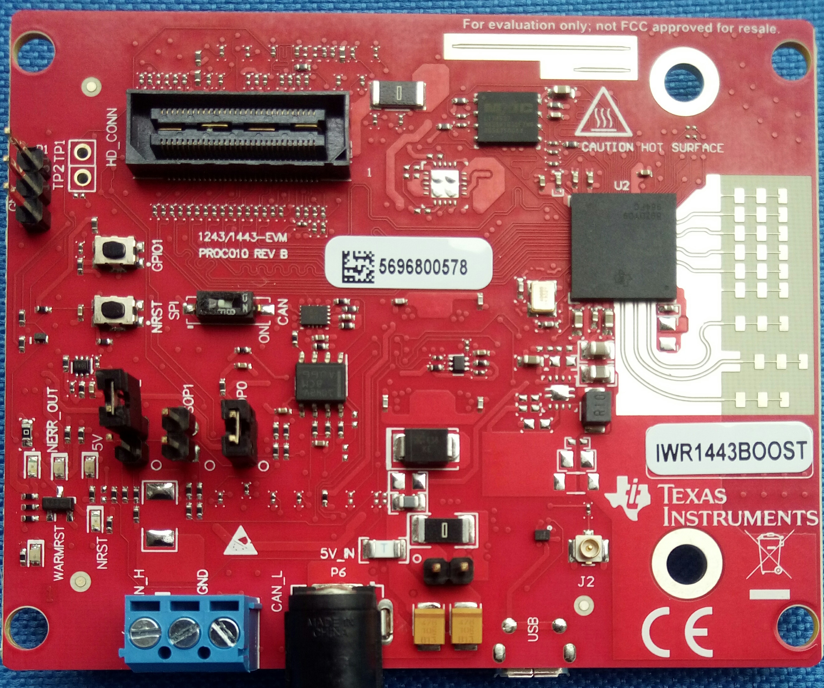

IWR1443 borad in my hand as pictures below:

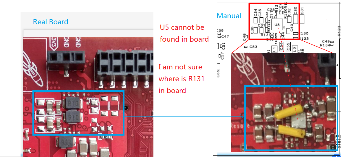

For IWR1443EVM board I find there are some differences between mamual and real board
