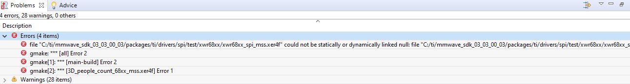

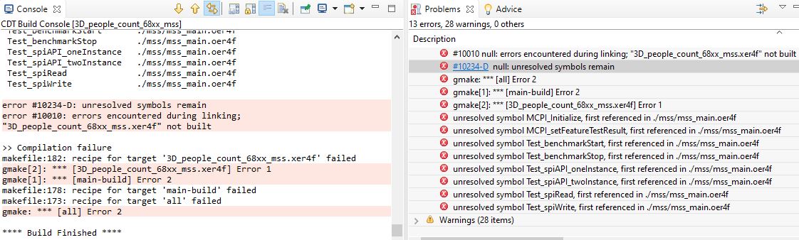

  • Hi Charles,
    I modified mss_main.c code, then added SPI lib to mss project path but the compile still got error. Please tell me a way to solve it.

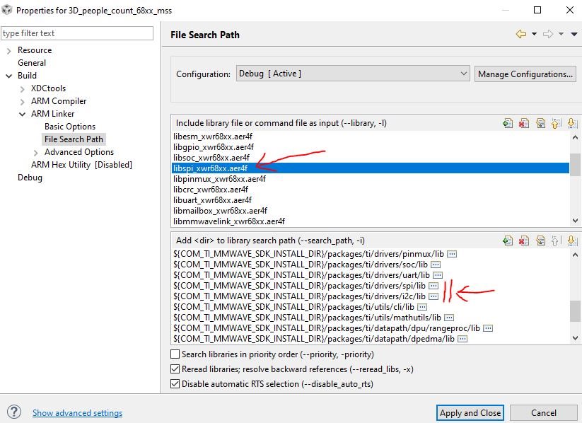

  • Hi Charles,
    I got less compiling error by adding xwr68xx_spi_mss.xer4f in the path C:\ti\mmwave_sdk_03_03_00_03\packages\ti\drivers\spi\test\xwr68xx to the project.
    Previously, I got 13 compile errors. After added xwr68xx_spi_mss.xer4f, now I only see 4 errors. Not sure whether this is better or not. But even if I don't use SPI function and remove all SPI commands, I still have these 4 errors after adding xwr68xx_spi_mss.xer4f to my project. If I don't add it, I only got compile error when I use SPI commands.
    How to solve it? I expect I can use SPI/I2C within this week, but I got stuck at library linking even though it seems to be easy.
    1. Here's the error after I added xwr68xx_spi_mss.xer4f
    error: "could not be statically or dynamically linked null: file "C:/ti/mmwave_sdk_03_03_00_03/packages/ti/drivers/spi/test/xwr68xx/xwr68xx_spi_mss.xer4f" could not be statically or dynamically linked 3D_people_count_68xx_mss C/C++ Problem
    2. Here's the error without xwr68xx_spi_mss.xer4f, I only added libspi_xwr68xx.aer4f in the path C:\ti\mmwave_sdk_03_03_00_03\packages\ti\drivers\spi\lib
  • Are you trying to build the SPI test code, or are you trying to link the SPI driver into an existing CCS project?  Nothing within the SDK builds within CCS by default - only gmake makefiles are used. The SDK user guide gives full instructions on how to build via gmake.  So if you want to rebuild the SPI test code, use gmake.
    If you are trying to include the SPI driver into your CCS project, then I question why are you trying to include SPI test code?
     -dave

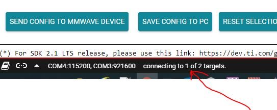

  • Hi Dave,
    Can I use visualizer of 3D_people_count toolbox? I tried it but it didn't work. Then I used TI cloud visualizer to connect to my Master EVM, but it was stuck at "device connecting". I waited for a long time but device couldn't connect. I'm wondering whether it's an error of TI cloud?
    Besides, if I use 3D_count visualizer, do I need to choose SDK_out_of_box_demo for testing? I chose SDK_out_of_box_demo with profile_2d.cfg as you said, but spi_slave still didn't receive any message. After that, I tried TI visualizer cloud as I mentioned above, but serial port didn't connect.
     Please tell me another way to enable SPI_write in demo code without TI cloud visualizer.
  • Dave,
    Currently, I can connect to TI visualizer cloud. But I can only adjust configuration on the interface. How to send my cfg from PC to device via TI cloud?
    Since I can't send cfg successfully on TI cloud. I used HVAC code and added SPI_write() into it. Then I ran 3D_people_count GUI to send profile_2d.cfg, I also tried to send sense_and_direct_68xx.cfg to EVM, but slave EVM still loop forever after SPI_open() was successful and can't read message.
    I checked all SPI & GND wires, their connection is still good. Is it possible that your code didn't assign matched SPI address for 2 EVMs? Where can I check that information?
    Is there any way to SPI_write without having to send configuration? All demo visualizer and 3D_count GUI didn't make SPI_write work after I sent profile_2d.cfg and many other cfg.

    About Cfg sending, I connected to UART port via Teraterm, set at baudrate 115200. There's 2 issues:
    1. When I flashed your demo code, then sent Cfg via Teraterm, it always showed: Error -1
    Please help me check the demo code you sent to me last time to handle this issue.
