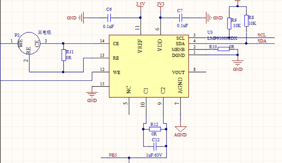

  • Hi Josh,
    Thanks. And customer has below following question need your help.
    1. He used LMP91000 to measure the gas concentration. He wrote commands to the LMP91000 through the IIC bus, and then sampled the VOUT terminal signal of the LMP91000 with the AD port of the single-chip microcomputer. Is that the concentration value? This was how he measured now, the measured data has been 0V. He did not add the electrode to measure, which is equivalent to LMP91000 no load.
    2. How to choose the resistance value of C1 terminal and C2 terminal of LMP91000? In the manual, C1 and C2 are indirectly connected with a 0 ohm resistor. But isn't C1 and C2 used to configure the transimpedance of TIA? If he connects a 0 ohm resistor, isn't the configured transimpedance impedance short-circuited?
    3. Is the customer's register setting correct?

  • Dear Annie -
    The TIA resistor gain is either internally set (with register 0x10, values 001b to 111b, for bits 4:2, in that register) or the register 0x10 is set to external (using same bits and set to 000b) and the gain setting is done with external resistor - it is not (and is not shown or described) as being shorted or zero Ohms.

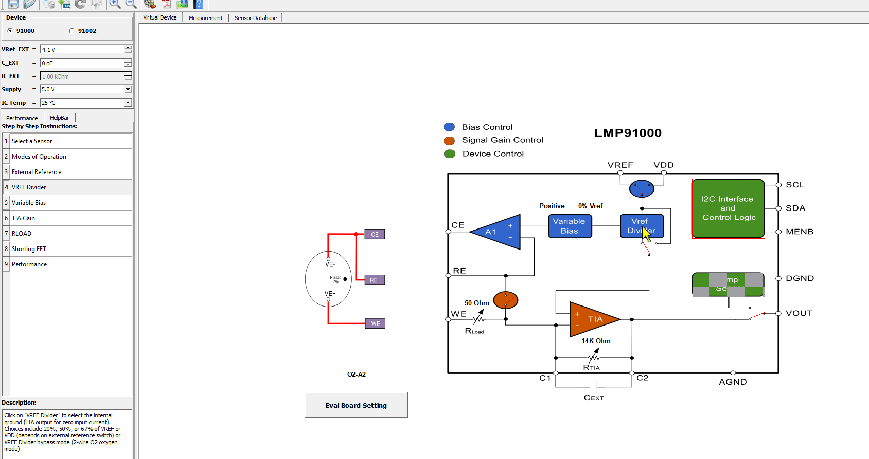

    The sensor example settings (as the specific sensor is not mentioned yet by you) can be found by using the EVM tool (even if you (or the customer) don't have the EVM, which I would recommend getting) -
    https://www.ti.com/lit/zip/snac007 (this is the software)
    https://www.ti.com/tool/LMP91000EVM (sensor board, which can connect directly to MCU, MSP430 source available on the product page, as you have already found, I think)

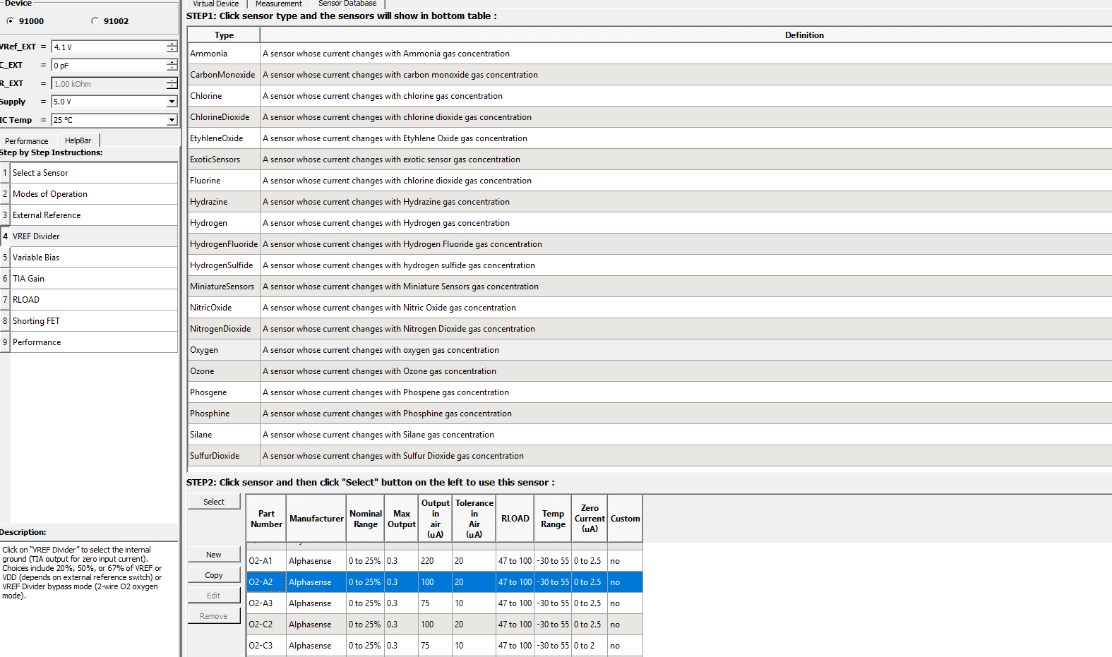

    one can choose the sensor being used from the database and get the basic settings - here you can see example with O2 sensor
    choose sensor:
    then see settings
