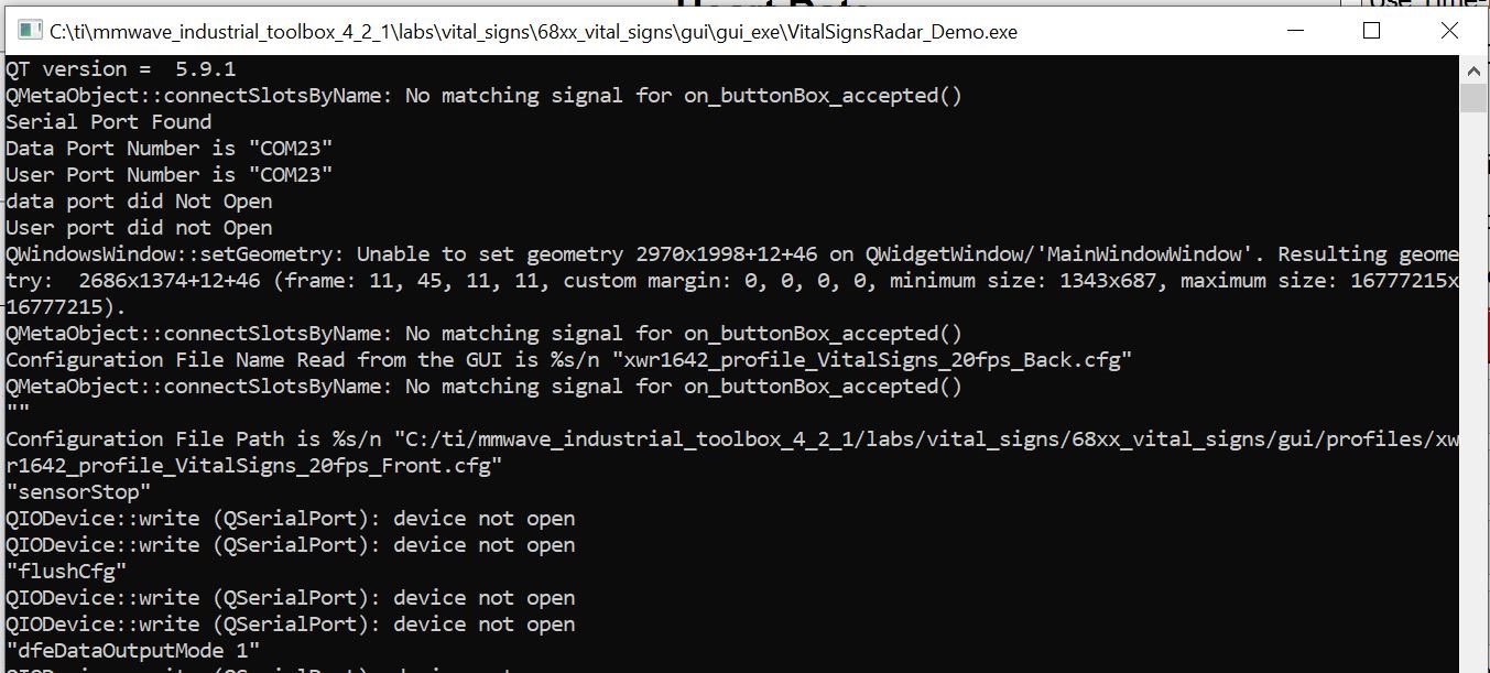

I'm using IWR6843 based EVM and tried to run Vital Sign Demo from mmWave industrial toolbox 4.2.1. When I run the default demo GUI, it is detecting wrong ports automatically.
So I modified the GUI source code from automatic detection of ports to manual. It connected to the ports successfully but failed to capture the data.

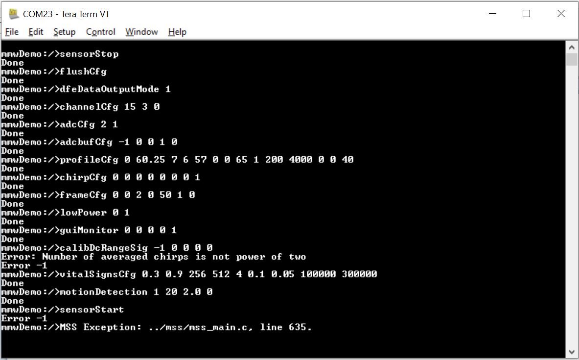

2. Instead GUI, tried to capture data via tera term and threw errors ("Number of averaged chirps is not power of two ") in configuration command (calibDcRangeSig -1 0 0 0 0) and in mss_main.c. Attaching the snapshot of it.

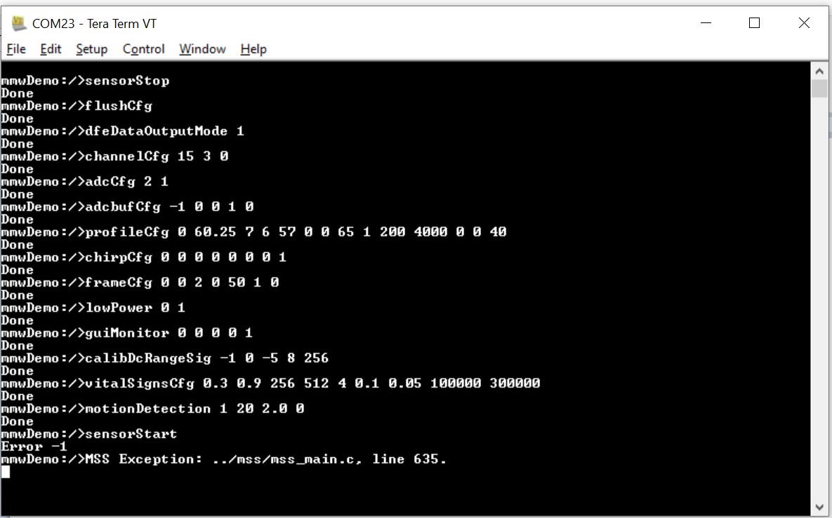

 The "calibDcRangeSig -1 0 0 0 0" changed to "calibDcRangeSig -1 0 -5 8 256" by referring the SDK user guide and it sent successfully. But I don't know how this will effect the demo.

    Still debugging this issue. I found that there is no event received from BSS and failed to open mmwave module. But I didn't get the reason why it is failing.
    The Out-of-Box demo is working fine. Only Vitals Sign is failing. I used profile configuration from "mmwave_industrial_toolbox_4_2_1\labs\vital_signs\68xx_vital_signs\gui\profiles\xwr1642_profile_VitalSigns_20fps_Front.cfg"

    The Vital Sign demo is only verified with SDK 3.3.Please use the same.
    You should be able to verify the data coming on uart data port after sending the chirp config
    The GUI currently only supports UART port through MMWAVEICBOOST. You will need to modify the GUI to support the UART on your custom boards.
