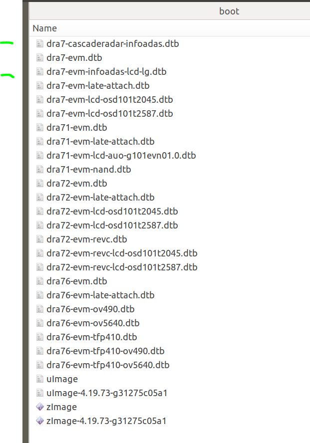

I changed the Eth0 static IP address following the instructions in the mmWave Studio Cascade User Guide section 11.1.
I built Linux following the instructions in Vision SDK (v03.08.00) Linux User Guide sections 2 & 3.
I set MAKECONFIG?=tda2xx_cascade_linux_radar in vision_sdk/build/Rules.make but I had to change fdtfile=dra7-cascaderadar-infoadas.dtb manually in the /vision_sdk/binaries/apps/tda2xx_cascade_linux_radar/hlos/linux/boot/uenv.txt file, for some reason it was trying to use dra7-infoadas.dtb which does not exist in the /boot directory.
I tried building with and without the patches applied from Vision SDK Linux Cascade Radar Data Acquisition Tool User Guide.
How can I fix these 2 failures?
  • Hi Thomas,
    Can you please share complete dmesg og?
    I have not tried this with cascade radar dtb but with infoadas.dtb, did not see the issue.
    RamPrasad
  • Hello RamPrasad,
    Here is the dmesg log:
    dmesg log output

    Did you set MAKECONFIG?=tda2xx_cascade_linux_radar in /vision_sdk/build/Rules.make when you did your build? I only have 2 infoads dtb files (shown below) in my /ti_components/os_tools/linux/targetfs/build folder. Which infoadas.dtb are you refering to?
    Tom
  • Hi Tom,
    I see dra7-evm-infoadas.dts in arch/arm/boot/dts directory. Can you build this and check the behaviour?
    Ram
  • Hello Ramprasad,
    This .dtb file was not able to boot. The kernel boot stopped after a message saying "[ 4.222083] Waiting for root device PARTUUID=75860135-02..."
    I build the .dtb file with the following 2 commands:
    1. cpp -nostdinc -I <your base installation path>/Processor-Sdk-Vision_03_08_00_00/ti_components/os_tools/linux/kernel/omap/include -undef -x assembler-with-cpp dra7-evm-infoadas.dts dra7-evm-infoadas.dts.preprocessed
    2. dtc -O dtb -o dra7-evm-infoadas.dtb dra7-evm-infoadas.dts.preprocessed
    Here is the boot messge:

    Here is the contents of my uenv.txt file in case it helps:
    fdtfile=dra7-evm-infoadas.dtb
    args_mmc=part uuid mmc 0:2 uuid; setenv bootargs "console=ttyO0,115200n8 vram=16M root=PARTUUID=${uuid} rw rootwait ip=none mem=1024M cma=64M"
    I get the following warnings when running the dtc command to build the .dtb file:
    dra7-evm-infoadas.dtb: Warning (unit_address_vs_reg): Node /opp-table/opp_high@1500000000 has a unit name, but no reg property
    dra7-evm-infoadas.dtb: Warning (unit_address_vs_reg): Node /ocp has a reg or ranges property, but no unit name
    dra7-evm-infoadas.dtb: Warning (unit_address_vs_reg): Node /ocp/l4@4a000000/scm@2000/scm_conf@0/clocks/sys_32k_ck has a reg or ranges property, but no unit name
    dra7-evm-infoadas.dtb: Warning (unit_address_vs_reg): Node /ocp/regulator-abb-mpu has a reg or ranges property, but no unit name
    dra7-evm-infoadas.dtb: Warning (unit_address_vs_reg): Node /ocp/regulator-abb-ivahd has a reg or ranges property, but no unit name
    dra7-evm-infoadas.dtb: Warning (unit_address_vs_reg): Node /ocp/regulator-abb-dspeve has a reg or ranges property, but no unit name
    dra7-evm-infoadas.dtb: Warning (unit_address_vs_reg): Node /ocp/regulator-abb-gpu has a reg or ranges property, but no unit name
    dra7-evm-infoadas.dtb: Warning (unit_address_vs_reg): Node /ocp/ethernet@48484000/slave@48480200 has a unit name, but no reg property
    dra7-evm-infoadas.dtb: Warning (unit_address_vs_reg): Node /ocp/ethernet@48484000/slave@48480300 has a unit name, but no reg property
    dra7-evm-infoadas.dtb: Warning (unit_address_vs_reg): Node /ocp/vdrm@0 has a unit name, but no reg property
    dra7-evm-infoadas.dtb: Warning (unit_address_vs_reg): Node /ocp/vdrm@0/crtc@0 has a unit name, but no reg property
    dra7-evm-infoadas.dtb: Warning (unit_address_vs_reg): Node /ocp/vpe has a reg or ranges property, but no unit name
    dra7-evm-infoadas.dtb: Warning (unit_address_vs_reg): Node /ocp/vip@0x48970000/ports/port@0/endpoint@0 has a unit name, but no reg property
    dra7-evm-infoadas.dtb: Warning (unit_address_vs_reg): Node /connector@1 has a unit name, but no reg property
    dra7-evm-infoadas.dtb: Warning (unit_address_vs_reg): Node /encoder@1 has a unit name, but no reg property
    dra7-evm-infoadas.dtb: Warning (unit_address_vs_reg): Node /encoder@1/ports/port@0/endpoint@0 has a unit name, but no reg property
    dra7-evm-infoadas.dtb: Warning (unit_address_vs_reg): Node /encoder@1/ports/port@1/endpoint@0 has a unit name, but no reg property
    dra7-evm-infoadas.dtb: Warning (pci_device_reg): Node /ocp/axi@0/pcie@51000000/interrupt-controller missing PCI reg property
    dra7-evm-infoadas.dtb: Warning (pci_device_reg): Node /ocp/axi@1/pcie@51800000/interrupt-controller missing PCI reg property
    dra7-evm-infoadas.dtb: Warning (simple_bus_reg): Node /ocp/l4@4a000000/scm@2000/scm_conf@0/clocks missing or empty reg/ranges property
    dra7-evm-infoadas.dtb: Warning (simple_bus_reg): Node /ocp/l4@4a000000/cm_core_aon@5000/clocks missing or empty reg/ranges property
    dra7-evm-infoadas.dtb: Warning (simple_bus_reg): Node /ocp/l4@4a000000/cm_core_aon@5000/clockdomains missing or empty reg/ranges property
    dra7-evm-infoadas.dtb: Warning (simple_bus_reg): Node /ocp/l4@4a000000/cm_core@8000/clocks missing or empty reg/ranges property
    dra7-evm-infoadas.dtb: Warning (simple_bus_reg): Node /ocp/l4@4a000000/cm_core@8000/clockdomains missing or empty reg/ranges property
    dra7-evm-infoadas.dtb: Warning (simple_bus_reg): Node /ocp/l4@4ae00000/prm@6000/clocks missing or empty reg/ranges property
    dra7-evm-infoadas.dtb: Warning (simple_bus_reg): Node /ocp/l4@4ae00000/prm@6000/clockdomains missing or empty reg/ranges property
    dra7-evm-infoadas.dtb: Warning (simple_bus_reg): Node /ocp/axi@0 simple-bus unit address format error, expected "51000000"
    dra7-evm-infoadas.dtb: Warning (simple_bus_reg): Node /ocp/axi@1 simple-bus unit address format error, expected "51800000"
    dra7-evm-infoadas.dtb: Warning (simple_bus_reg): Node /ocp/regulator-abb-mpu simple-bus unit address format error, expected "4ae07ddc"
    dra7-evm-infoadas.dtb: Warning (simple_bus_reg): Node /ocp/regulator-abb-ivahd simple-bus unit address format error, expected "4ae07e34"
    dra7-evm-infoadas.dtb: Warning (simple_bus_reg): Node /ocp/regulator-abb-dspeve simple-bus unit address format error, expected "4ae07e30"
    dra7-evm-infoadas.dtb: Warning (simple_bus_reg): Node /ocp/regulator-abb-gpu simple-bus unit address format error, expected "4ae07de4"
    dra7-evm-infoadas.dtb: Warning (simple_bus_reg): Node /ocp/sata@4a141100 simple-bus unit address format error, expected "4a140000"
    dra7-evm-infoadas.dtb: Warning (simple_bus_reg): Node /ocp/target-module@4a0dd000 simple-bus unit address format error, expected "4a0dd038"
    dra7-evm-infoadas.dtb: Warning (simple_bus_reg): Node /ocp/target-module@4a0d9000 simple-bus unit address format error, expected "4a0d9038"
    dra7-evm-infoadas.dtb: Warning (simple_bus_reg): Node /ocp/vdrm@0 missing or empty reg/ranges property
    dra7-evm-infoadas.dtb: Warning (simple_bus_reg): Node /ocp/sham@53100000 simple-bus unit address format error, expected "4b101000"
    dra7-evm-infoadas.dtb: Warning (simple_bus_reg): Node /ocp/vpe simple-bus unit address format error, expected "489d0000"
    dra7-evm-infoadas.dtb: Warning (simple_bus_reg): Node /ocp/vip@0x48970000 simple-bus unit address format error, expected "48970000"
    dra7-evm-infoadas.dtb: Warning (simple_bus_reg): Node /ocp/vip@0x48990000 simple-bus unit address format error, expected "48990000"
    dra7-evm-infoadas.dtb: Warning (simple_bus_reg): Node /ocp/vip@0x489b0000 simple-bus unit address format error, expected "489b0000"
    Tom
  • Any update on this RamPrasad?
    Tom
  • Please set it to dra7-cascaderadar-infoadas.dtb in uenv.txt on SD card when booting the cascade radar EVM.
  • Did you see the text in the original question?
    "I set MAKECONFIG?=tda2xx_cascade_linux_radar in vision_sdk/build/Rules.make but I had to change fdtfile=dra7-cascaderadar-infoadas.dtb manually in the /vision_sdk/binaries/apps/tda2xx_cascade_linux_radar/hlos/linux/boot/uenv.txt file, for some reason it was trying to use dra7-infoadas.dtb which does not exist in the /boot directory."
