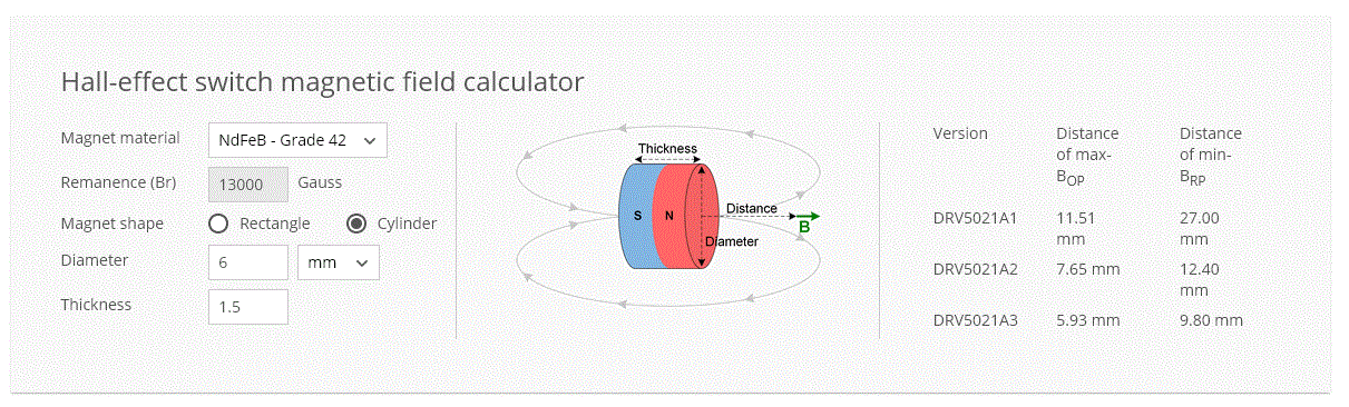

Hi sir,
Can you give me some Suggestion on product selection?
Requirement: Hall sensor switch
Hall sensor PCB system which have 8*8 hall sensor matrix
Pieces should be detected only at particular height
Output signal: Digital pulse
Height of detection : within 6mm from the surface
Power: 3.3~5v
Neodymium magnet detection : N42 6mm*1.5mm cylindrical size
thank u,
  • Hayashi-San,
    Could you clarify which length is the diameter of the magnet?  The two geometries will behave differently. I assume there is an existing system and placement of the sensor cannot be adjusted much?
    There is a calculator tool available on each of the DRV5032, DRV5023, or DRV5021 landing pages that can help with this sort of activity.  It allows the user to enter magnet dimensions and it will report the distances to trigger BOP and BRP for the various sensitivities.
    DRV5032
    DRV5021
    DRV5023
    In the above cases, the calculator shows the maximum BOP points for the magnet settings provided. The closest device to the specific distance provided would be DRV5021A3.  In all of the cases above this value is based on the datasheet maximum value for BOP to ensure all device would trip by the advertised distance.
