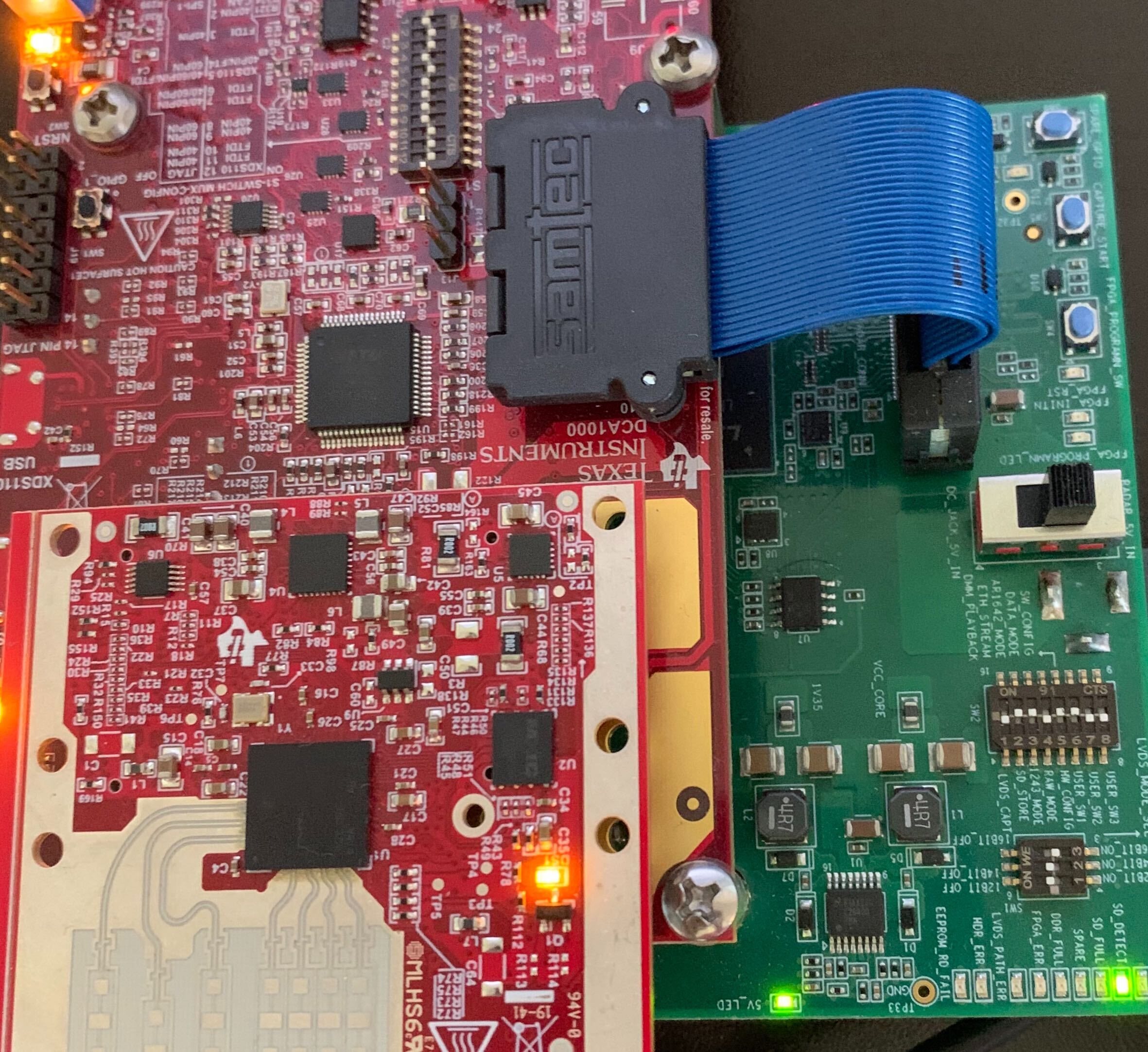

I am using the IWR6843ISK + MMWAVEICBOOST + DCA1000EVM to stream raw data through LVDS. I was wondering what commands/scripts I need to store that data without using the visualizer or mmwavestudio?
Essentially, I need to control the sensor start, sensor stop and data capture but there I can't find any documentation on that.
Thanks!

  • By the way,
    1) Did you flash the out of box binary to your target EVM?
    2) Please run the following command to reset the target EVM.
    system(['DCA1000EVM_CLI_Control.exe reset_ar_device ', datacardConfigJsonFile])
    3) Please check the hardware setup as attached.  Please pay attention to the switches that is in yellow circle.
  • Hi Zigang,
    I am able to run the code but not receiving any packets. My output is printed below.
    While our mmWaveICBoost switches are in the same configuration. I am confused as to why your switches for the DCA1000EVM are in the way that they are. Attached is a picture of my configuration.
    - DIP Switch 2.2 is set to ETH_Stream
    - DIP Switch 2.3 is set to AR1642_mode for 2 lane LVDS.
    - DIP Switch 2.6 is set to GND (FPGA Configuration mode).

  • I see. Please add bpmCfg towards the end of chirp1_60G.cfg, like below.
    lvdsStreamCfg -1 0 1 0
    bpmCfg -1 0 0 0
    sensorStart
  • Hi Zigang,
    should it be lvdsStreamCfg -1 1 1 1 (as listed in the mmwave sdk user guide for LVDS )
    or should it be lvdsStreamCfg -1 0 1 0
    Thanks!
  • You can check the details in SDK users guide about every parameter in lvdsStreamCfg.
    My configuration is set for raw data capture only, no header or point cloud.  Just raw ADC data.
    Zigang
  • Hi Zigang,
    This seems to work. Quick question: can we export a configuration file (.cfg) from mmwavestudio?
    The current config file (chirp1_60G.cfg) does not let me send 256 chirps. There seems to be some discrepancy between mmwavesdk and the actual config file.
