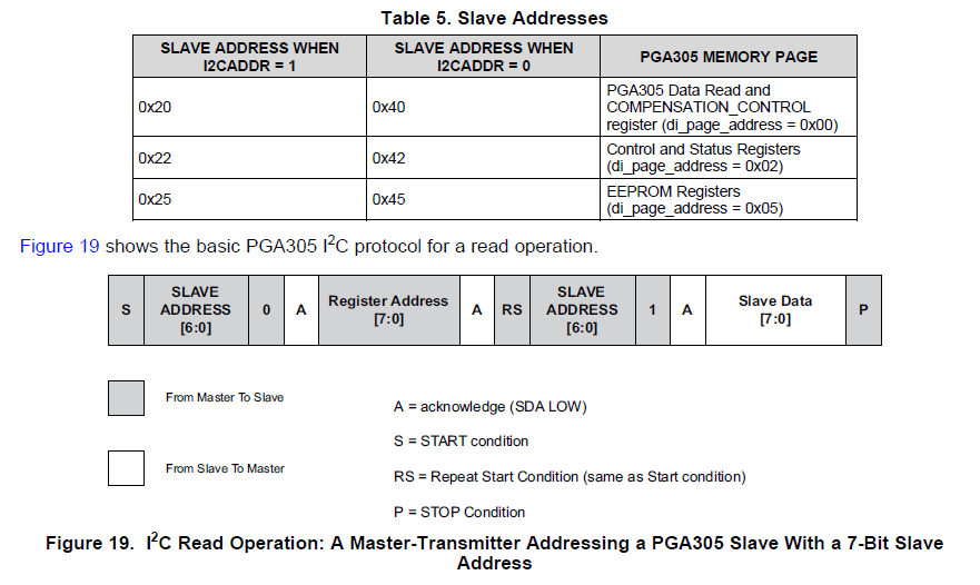

I am trying to read via I2C some register but I can't understand why, probably because I transmit the wrong address.
For example, I wish to read:
PADC_GAIN_MSB with DI page and offset = NA and address 0x40000046
I2CADDR = 0 so the slave address is 0x40.
So I have to trasmit the slave address (0x40) the register address (0x46) then again the slave address, is it correct?

  • Hello Andrea,
    The EEPROM space is actually part of a different slave address. If I2C_ADDR = 0, then you access the EEPROM for reads by using the slave address 0x45:
    For a read directly from the EEPROM, you will just use the EEPROM address shown in the register map 0x46. Note that even though Table 20 shows the PADC_GAIN_MSB as a "Control and Status Register" since it has an EEPROM address, you will access it by using the EEPROM register slave address.

  • Only the EEPROM registers can be read using slave address 0x45.
    To write to the EEPROM, you have to use the EEPROM cache. Please refer to the "EEPROM Programming Procedure" section of the datasheet. There are 16 pages of 8 bytes each, and you can write a single page with the contents of the EEPROM cache. The page of a specific register is determined by using the last byte of the EEPROM address and counting up from 0x0. So 0x0 through 0x07 will be on page 0, 0x08 - 0x0F will be on page 1, etc.
    If the register is also available outside of the EEPROM, you can use the DI offset while using slave address 0x40.

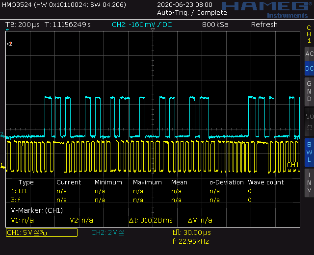

    I'am having problems reading the register, unfortunatly we use a uC with any I2C port so we emulated it with PWM. I try to debug with an oscilloscope and it seems fine. Sometimes I successfully read the register some other no.

    Are you placing the device in reset mode before attempting to read and write registers? You will need to write 0x03 to register 0x0C (slave address 0x40) to put the PGA305 in reset and then you can properly read and write all the registers.
    If you are already doing that, it is likely some kind of I2C timing error from the master. You can post some examples of I2C transactions that are unsuccessful and I will take a look. Include SDA, SCL, and CS in the scope captures.
  • Yes, i put the PGA in the Reset mode. It reads casually some registers and usually different, not always the same.
    Here the register 0x35, it should read 132 (decimal). The second picture read 0x54 and sould read 0x12
  • In the upper post you will see that the receive byte has 9 bit instead of 8. In this way it works wometimes.
    I tried to modify for receiving 8 byte as the I2C protocol say but in that version it never read. i post a screen for this too.

    I solved my issue. I tell you how as it can help:
    • I manage the CS making a read after every write of SDA and SCL.
    • I removed every delay inserted after every write of SDA or SCL, the transmission was probably too slow.
    • I add a control after every read, when I read all the register at the beginning sometimes it skips some register after an error.
    Thank you again for you support.
