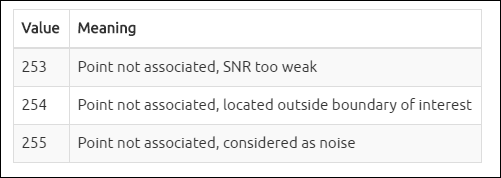

    At certain frame, the Target List TLV includes 2 targets whose IDs are 0 and 1. Therefore, I should expect to see target ID 0 and 1 in the Target Index TLV as well but I only see target ID 1 in addition to target IDs greater than 249. Why is target ID 0 not included in the Target Index TLV?
    For a given index i, If target_index[i] > 249, it means that, that particular point in the point Cloud TLV, i.e. pointCloud[i] was not attached to any target Id due to one of the following reasons as given in the demo user guide:
    So the condition you see above is not an error and not all the points always map to a known target due to one of the above reasons.
    Hope this clarifies the doubt but please get back if you have more questions.
