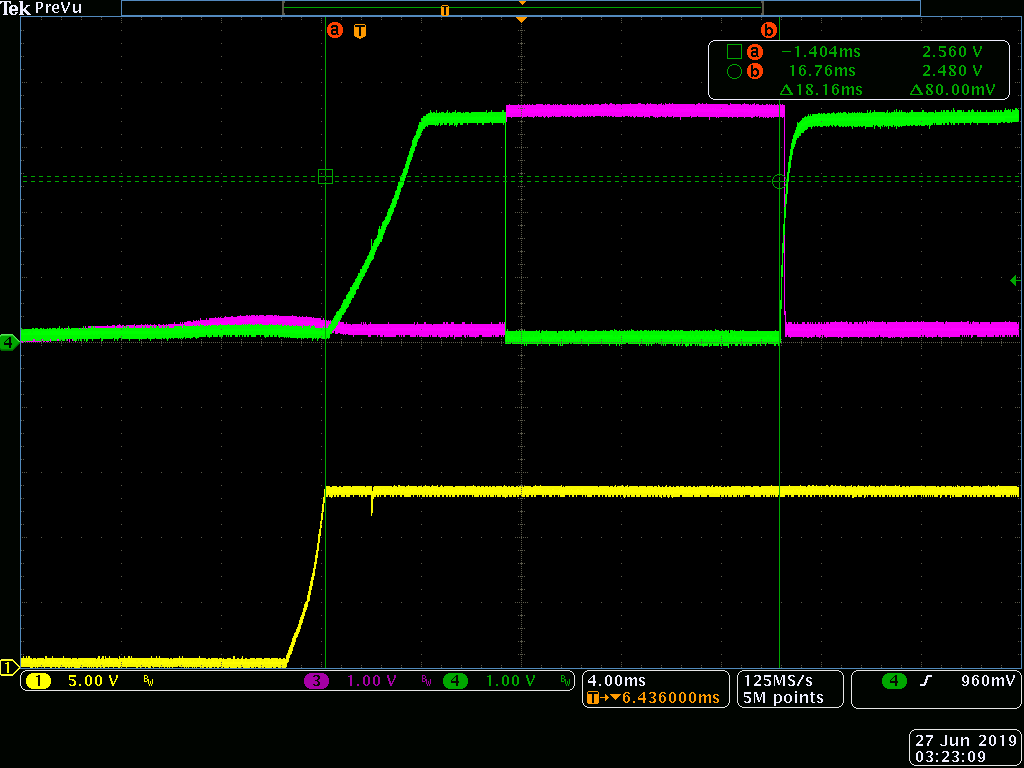

Is there any known issue with the TMP392 having a 1-2ms "blip" on it's output upon being powered up?
This sensor shuts down our converter directly after start-up, and it seems that for some reason, even at cold start, there is this small event where the output is pulled low for a brief moment. There is a lot going on during this instance of time, but I looked and the event does not seem to correspond with any other switching event in the power supply- the boost PFC is already up and switching, the power supply which powers the TMP392 and the output pull-ups is already up- so it does not appear to be "induced" but rather just something that the part does on it's own.

  • Hi Jalen,
    Both channels are, somewhat randomly, with Channel A doing it more frequently than channel B.
    In the scope shot above, the green is the output of the temp sensor. The pink is the schmitt trigger inverting buffer following the temp sensor. The yellow trace is the power supply that powers the 3.3V switcher (It is mislabeled in the screen capture below- disregard that.) that runs the temp sensors, the pull up resistors, and the inverting buffer. Here is a screen capture of the schematic.

    There is brief mention of the "Power reset time" in the electrical characteristics table, as shown below:
    Can you please ask the design team today if there is any known behavior in which the output may go high during that 10ms? Unfortunately, we'll have to make a decision on whether or not to pull this circuit by tomorrow morning, so appreciate your quick response.

    1. Are the resistor values used have the 1% tolerances as required by the data sheet. If you can send us the part numbers for the resistor that will be great
    2. You mentioned that there is a 1-2 ms blip, however looking at the scope snapshot and time base it looks like more than 11-12 ms. Please correct me if I am reading the time base on the scope snapshot incorrectly.
    3. At what temperature are you powering up the device?
    4. Is this an issue on every board you have or is this a one-off.
    Having said that we have not received a report on any such issue so far. Is it possible for you to remove the schmitt trigger and op-amp buffer and check the behavior?

  • Amit, Jalen,
    We removed the temp sensor from the design until we can understand it's expected behavior (or we find another solution).
    To answer your questions:
    1. Yes- 1% resistors. Specific part numbers will not be supportable from a long-term sourcing perspective, so assume any generic popcorn device.
    2. The blips are spurious, and not always the same width. Sometimes they don't happen at all.
    3. The device is being powered up at room temp.
    4. Issue on every board.
    "... we have not received a report on any such issue so far.."
    Can I assume that this means that the spurious toggling of the outputs is confirmed as unexpected behavior? If so, we can dig in a little deeper. (If not, I'd like to not spend any more time on it and just find another solution.)
    To ask another way- What does the spec "power reset time" pertain to? Is this simply how long the temp sensor will take to trigger after being powered up, or does this mean that the outputs are invalid until 10ms after power-up?

  • Hello Cody
    We checked with our design and the only condition this could happen is if the resistor are incorrectly decoded during power up. That is where the specs for the resistors other than 1% are also important, i.e TCR of 100 ppm/C and LTD of 0.2%. If you can share the part numbers, we can source the same and check it on the EVM to reproduce the failure and root cause the same.
    The spec on power reset time is where the device spends time to decode the resistor and get the first temperature readout for comparison against the set threshold. During the time of power reset, the output are help inactive. Only, when the first stage of decoding and temp comparison is complete, does the output toggle.
  • Thanks Amit, this is useful information.
    The resistors used are: CRCW0402332KFKED and CRCW040214K0FKED. As you can see they are 1% and 100ppm/°C.
    I think that, when the device is first starting up, it is trying to get it's decode in a really noisy environment- since simultaneously the PFC next to it is coming to life.)
    It also is on the top layer, which is capacitively coupled to the PFC boost swiching node via an internal plane, so that could be making for a rough go of the initial decode. It seems to work very well when powered from an external supply, so that seems like it could be the culprit.
    I'll circle back when we have a chance to do a bit more testing. Thanks again Amit.
  • Hello Cody
    Thanks for posting back with the resistor part numbers. I agree that the specs meet up as expected by TMP392. At the same time your assessment is correct. In a noisy environment, any external noise could cause an issue for resistor decoding. The good news so far is that the device does reattempt to acquire the resistor value.
    Let me check with Jalen as to what can be done to reduce the coupling of noise.
