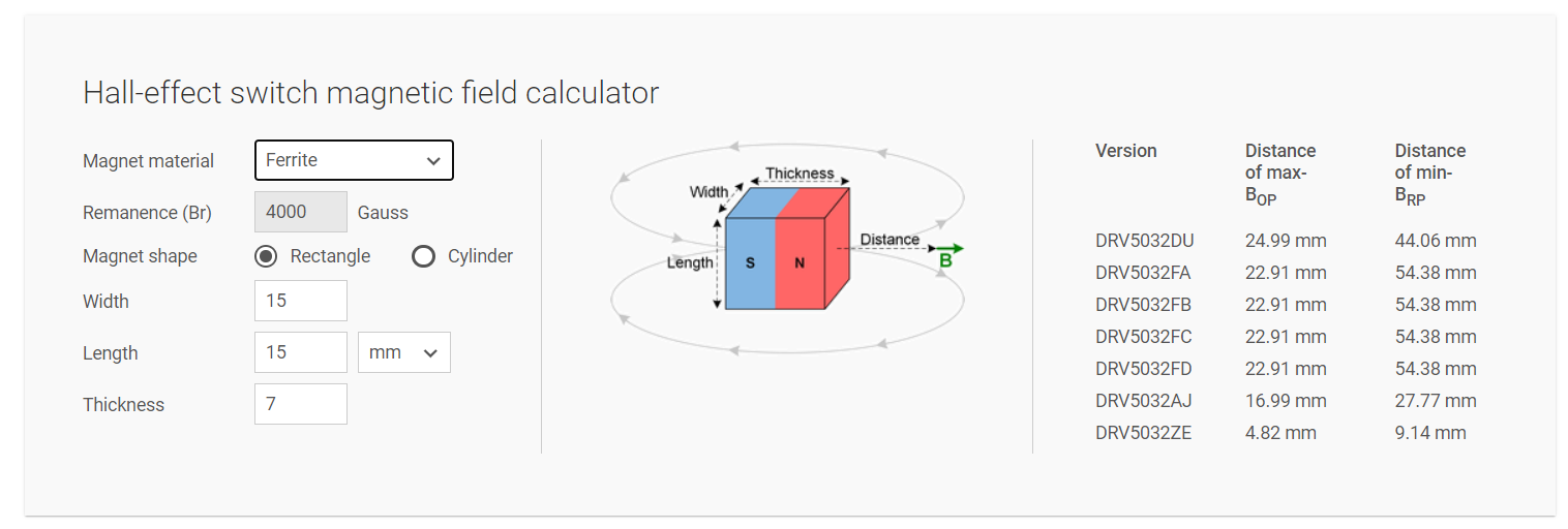

Hi Sir,
Customer using DRV5032 found sensor issue, some devices cannot detect success.
We check ID tolerance looks fine, guess if possible cause by Bop higher. Would you pls kindly advise?
Hall element (mT)
close |
5.0mT |
open |
0.09mT |
