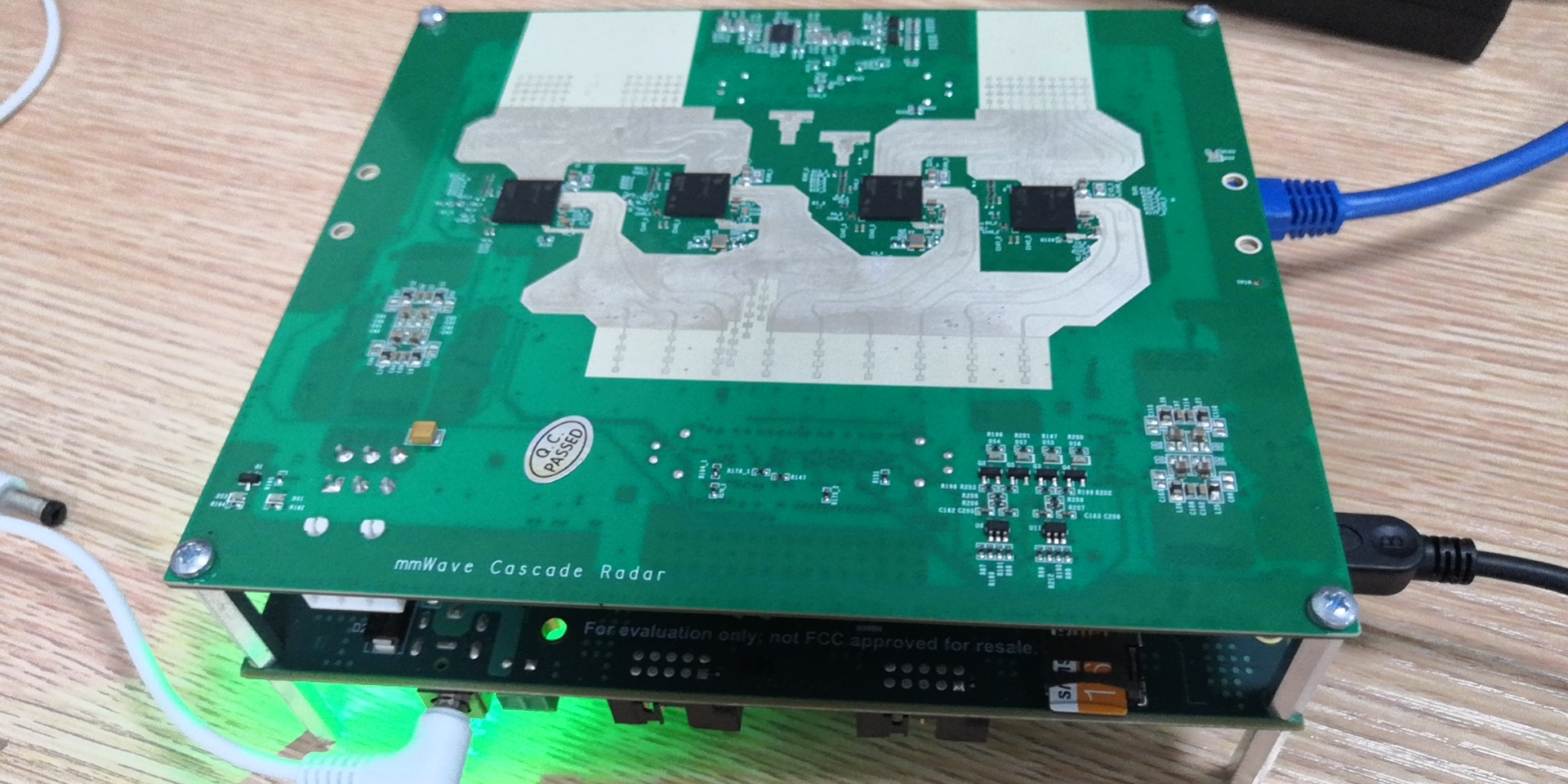

We designed and manufactured a cascade radar RF board according to the design scheme of TIDEP01012, but it is not powered after it is connected to the following signal processing evaluation module.
What should we do?

  • Hi user6010015,
    I would start with debugging the 5V to AWR LP87424P, power management IC (PMIC) regulators (reference designators U3 and U4). Those PMIC are setup in the MMWCAS-RF-EVM schematic to come out of reset and power sequence the AWR devices as soon as 5V is provided from the Host Interface connectors (J4 and J5), SYSTEM_5V0 power net.
    From your photo, it does not appear that LED DS1 or DS3 are being enabled, even though the attached MMWCAS-DSP-EVM board is attached and powered on. This indicates to me that 5V (SYSTEM_5V0) is not being supplied from the J4 and J5 connectors for some reason.
    After good power is supplied to the AWR devices, you can move on to the other fundamental signals from the TDA2 host: reset, clocking and SOP select and the SPI connectivity. If all of that is good, the devices should boot and be mastered from the TDA2 host/mmWave Studio.
    Please let me know what you find.
