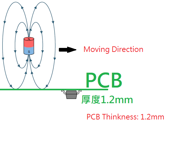

Could you help to check if the magnetic field moving direction is as below, is it ok to be sensed with DRV5056?
Brian W
Brian W

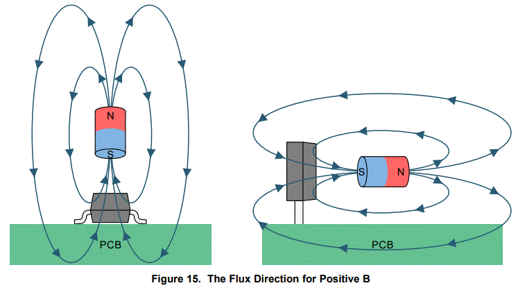

DRV5056 is a unipolar sensor expecting a positive B field as represented in the image below
In the case you mention, there will be a very weak positive B field at first when the magnet begins to move closer to the sensor. However, at some point as the magnet moves we would observe this change to a strong negative B field for the area closest to the sensor. I expect what is intended is to measure the B field as the magnet is above the device. This would be best done by rotating the magnet 180 degrees to invert the B field polarity observed.
