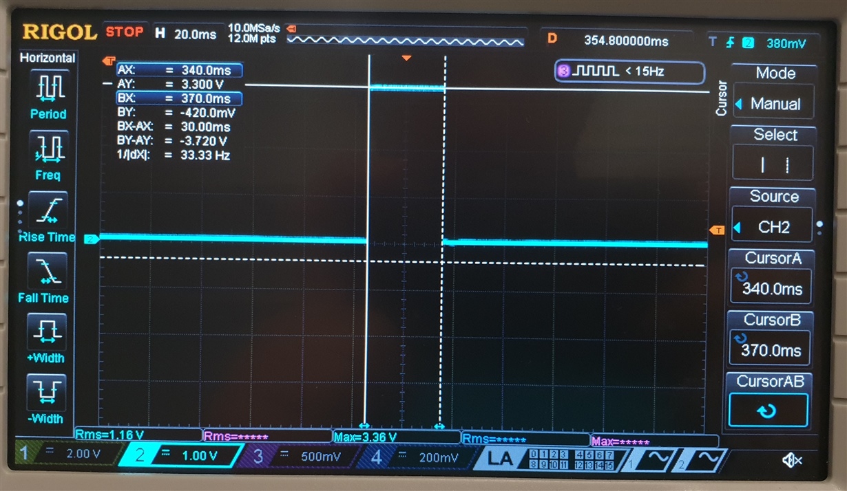

I am trying to synchronize two sets of DCA1000 and AWR1642BOOST.
According to the advice received in a previous thread, I followed the details available on section 5.9.2 of AWR1243 data sheet.

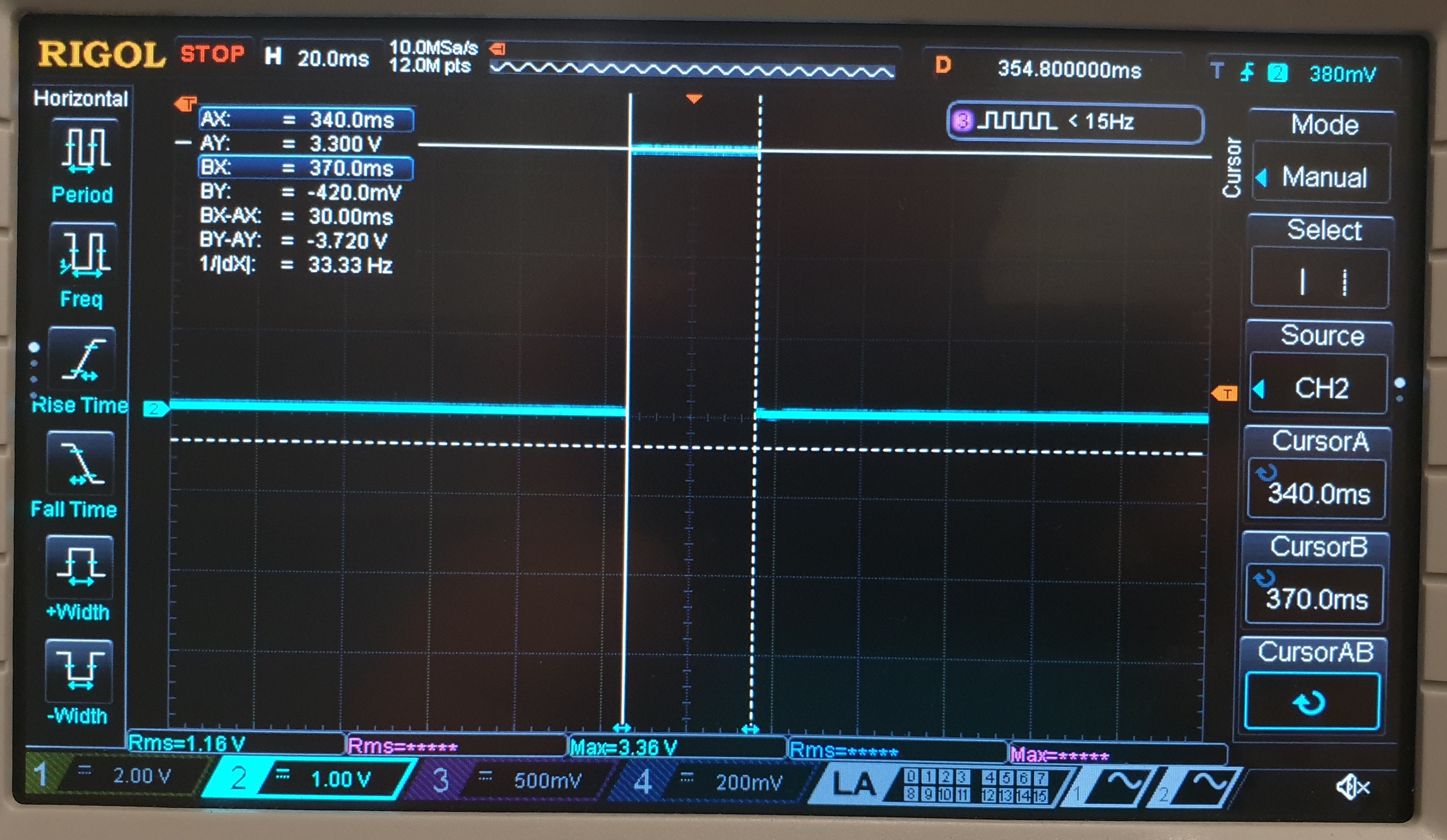

I used a microcontroller (Arduino board) to feed the AWR1642BOOST board (Pin number 9 in J6 Connector Pin) with a 3.3V pulse of 30ms duration to trigger the radar frame (Frame periodicity is 40ms).

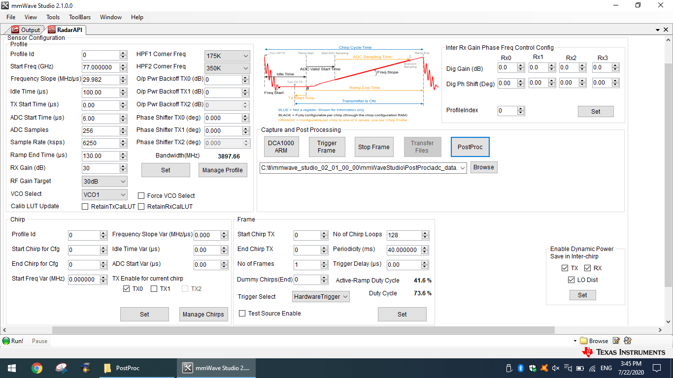

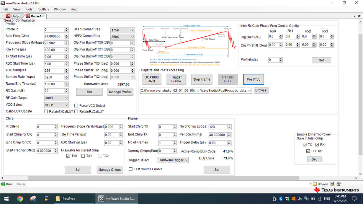

I used mmWave studio to power the two boards, set all the parameters exactly as when the radar is software triggered with the exception of setting the "Trigger Select" to "HardwareTrigger" in the Frame settings in the the Sensor Configuration Tab.
With all that being done, the radar set is still not responding to the pulse (i.e. not externally triggered).
Please see the attached pictures for more details.
Thank you.

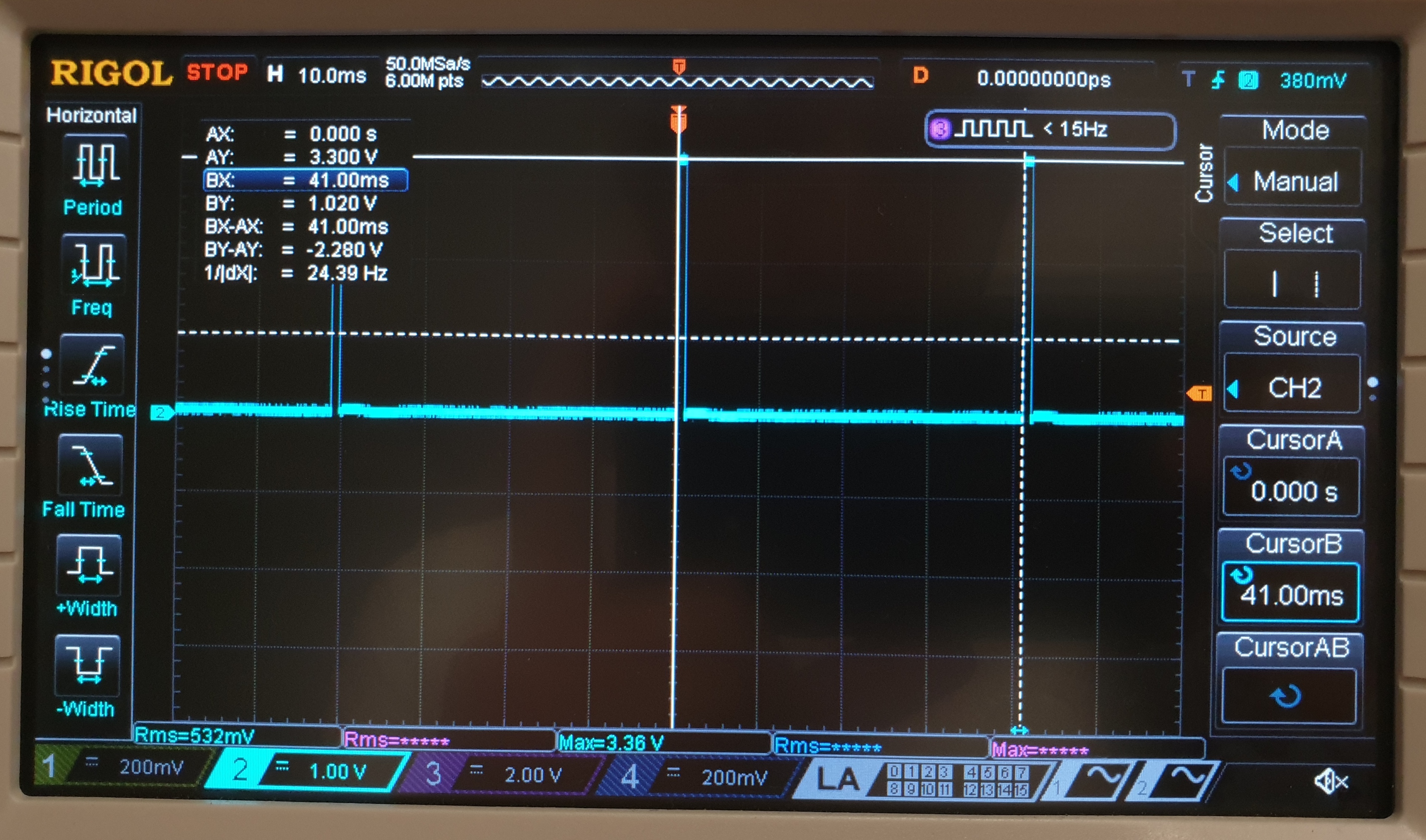

  • Hi Vivek,
    Both the Arduino and the AWR1642BOOST are powered on at the same time, then the pulse train starts after the AWR1642BOOST is initialized and the "Trigger Frame" button is hit.
    The signal from the output pin of the Arduino is fed directly to the SYNC_IN pin in the AWR1642BOOST board with no resistors or any other circuit components in between.
    All of this, BTY, happens while the AWR1642BOOST is connected to the DCA1000 to capture the data.
    Please see the picture below as I changed the SYNC_IN signal from a single pulse to pulse train as advice in the previous response.
    However, the radar is still not triggered in the "HardwareTrigger" mode.
    Thanks.

  • Hello Ahmad,
    How many frames are you triggering and are all the frames been sent out or only the first frame? In HW triggered mode the frames cannot get triggered unless the devices sees a high level on the SYCN IN pin. Can you probe the SYNC IN signal close of the AWR1642 pin and check the level? Disconnecting it from Ardrino does not guarantee the signal is low, it needs to be driven low
    Vivek
  • Hi Vivek,
    I am setting it to send 8 frames and it was all sent out.
    However, the ver B EVM is working great now. Your last set of instructions was perfect but it didn't work out for me before because I didn't do proper grounding (the two circuits didn't have a common ground!).
