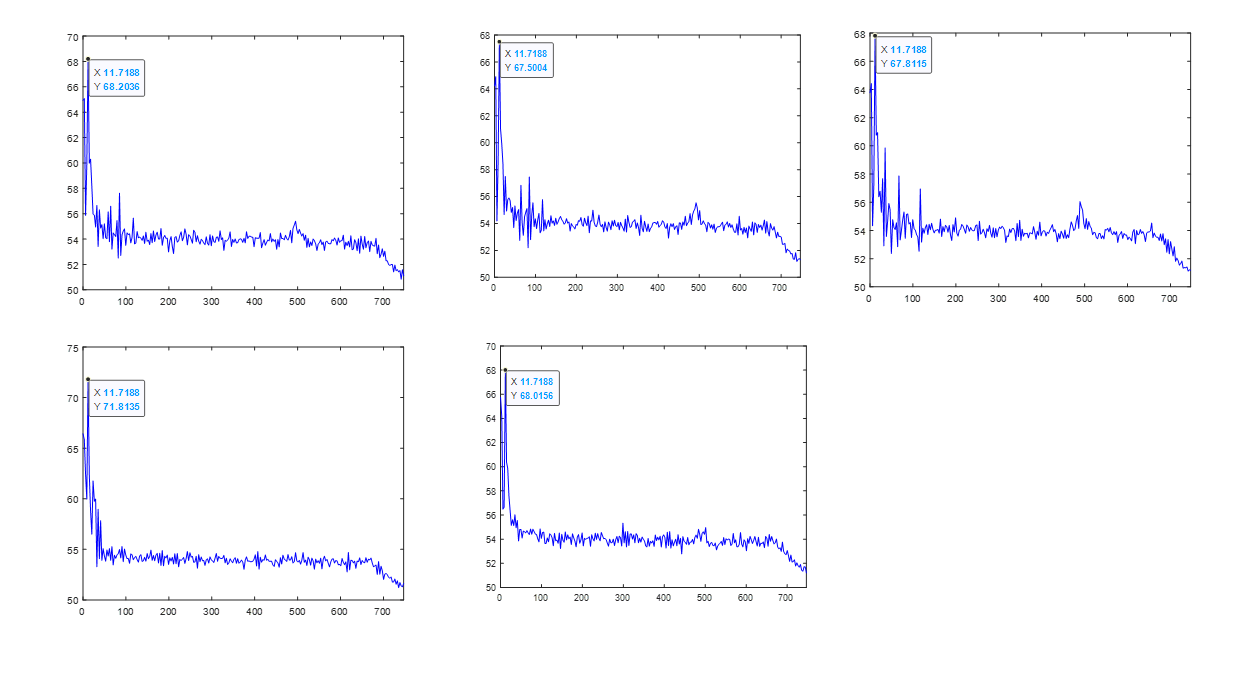

AWR1243BOOST: I am constantly seeing a target at around 11.72m which is not existent.
Part Number: AWR1243BOOST
Other Parts Discussed in Thread: AWR1243,
I  have encountered some problems when measuring with awr1243. So, i maybe need your help.
I used awr1243 to measure, but the result always shows that there is a target at 11.72m. there is always a target at 11.72m In different scenarios. I have tried many times even in a darkroom
Also, can I see the measurement results in real time during measurement with awr1243? Instead of receiving the raw data back for processing and seeing the results

  • Hi, Cesar
    I'm sorry to reply you so late. We use AWR1243BOOST EVM+TSW1400 in experiments.
    We have tried to point it to the sky with the bandwidth of 75MHz, 150MHz, 750MHz and 1500MHz respectively. The result is shown in the figure.
    It is seen that there always artefacts in the figure. Also, it is very strange that the range of the artefact changes with the bandwidth. For examples, 11.72m @B=75MHz, 5.86m@B=150MHz, 1.17m@B=750MHz, 0.58m@B=1500MHz.
    We also found that there are other unkown targets in the figures. For examples, there is a target at approximately 500 @B=75MHz and 50m @B=750MHz.
    We wonder that if we operate the device or process the data incorrectly?

  • Hi, Cesar
    We have post process the data with matlab included in the mmWave Studio. The results of Channel1-4 are shown in the figure.  It is seen that there are artefacts in the figure.
