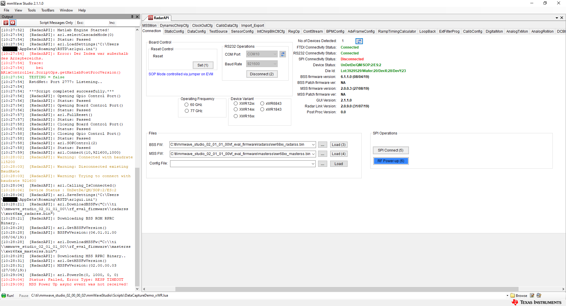

I have connected the IWR6843 AOP ES2.0 to the mmWaveICBoost and the DCA1000. I have already successfully started up the mmWave Studio with AOP ES1.0: https://e2e.ti.com/support/sensors/f/1023/t/931814/ .
With the AOP ES2.0 I tried the frimware from mmWave Studio v2.1.1.0 and the mmWave Studio v2.1.0.0, but I could not establish a SPI connection.

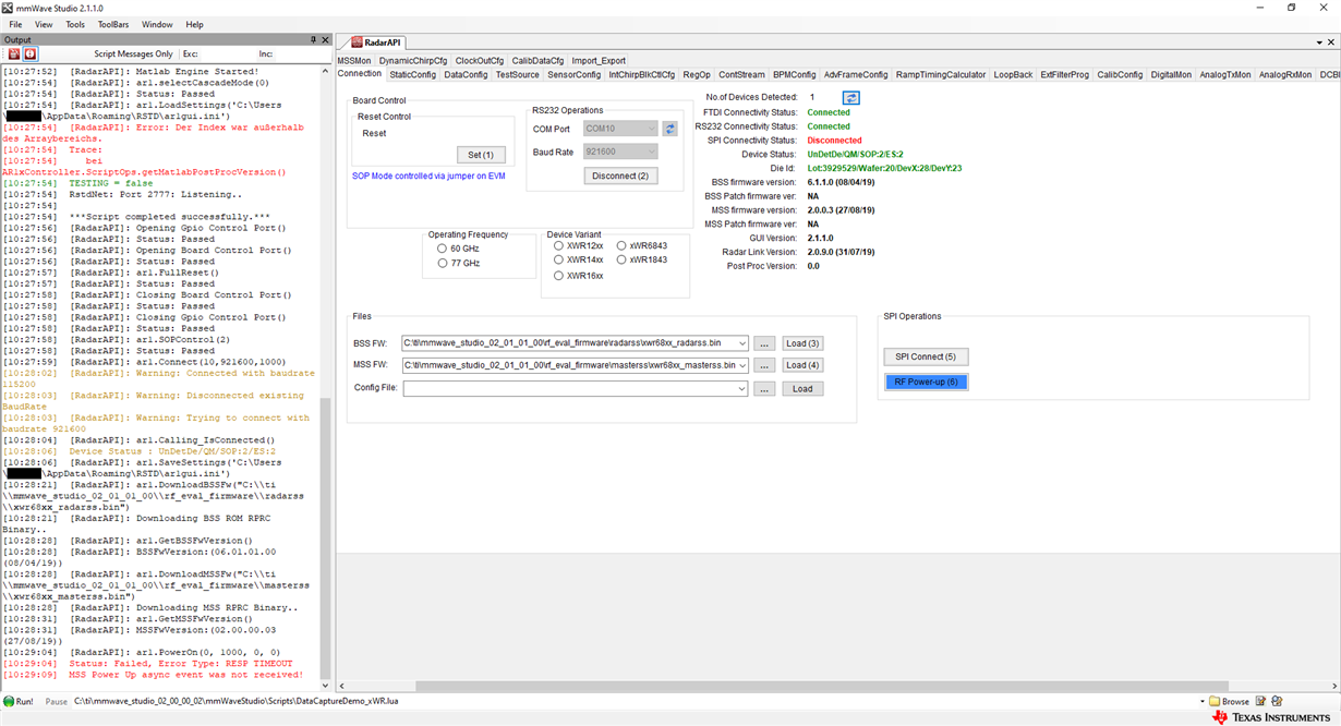

  • Hi, Zigang,
    I followed your instructions, but it didn't solve the problem. I keep getting an error "RESP TIMEOUT" and "MSS Power Up async event was not received!" after about 30 seconds. I also tried it with the 77 GHz setting, but it still did not solve the problem.
    Max

  • Hi, Zigang:
    Yes, the dip switches on the DCA1000 board were not the same.
    I took mine from the User Guide. There the dip switch settings are a bit misleading. A help would be to mention this in the Quick Start Guide.
    I already had a separate power supply in use.
    Thanks a lot,
