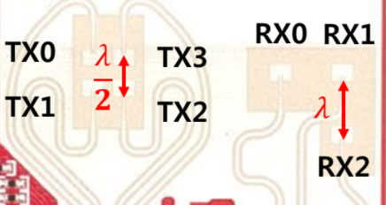

3. It says that we have to set a strong target at the distance of X meter at boresight. Were should we choose the center of our antenna system?
We have this antenna layout

  • Hi Denis,
    Before I address the questions, please note that you have the TX and RX annotations in your picture are incorrect (swapped). The 4 patches to the left are the RX channels and the 3 patches to the right are the TX channels (the device has 3TX and 4RX).

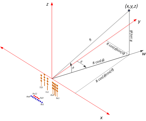

  • Hi Denis,
    Correcting my previous response to question 3 below i.e. what should you consider as bore-sight.
    Ans: The boresight line is shown in the mmw demo HTML documentation (file:///C:/ti/mmwave_sdk_03_04_00_03/packages/ti/demo/xwr68xx/mmw/docs/doxygen/html/index.html) as the perpendicular drawn from the center between TX1 and RX4 as shown below:

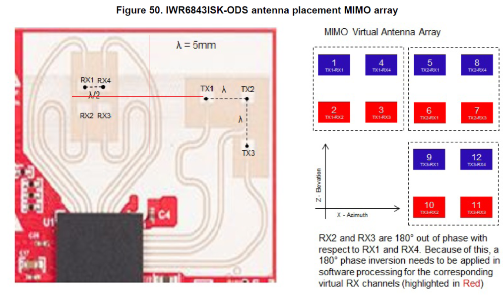

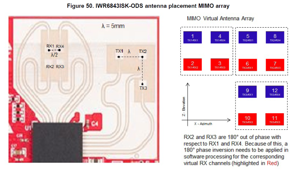

  • Hello, Nitin!
    Could you please place the boresight spot on this image of 2D antenna layout plane?
  • Hi Denis,
    The antenna geometry for the IWR6843AOP antenna is defined in the AoA2DProc DPU HTML documentation available at the following path:
    file:///C:/ti/mmwave_sdk_03_04_00_03/packages/ti/datapath/dpc/dpu/aoa2dproc/docs/doxygen/html/index.html
    The ODS antenna is similar just inverted so you can assume the boresight location as shown below
    Please refer to the following thread for the same discussion.
    IWR6843ISK: Combined Antenna boresight for ISK
    As noted in the thread referenced in this post, the exact location of origin is not defined and relevant for far field (far field is the assumption made in angle/range calculations) which is considered to be anything beyond 10cm in the demo code. So for calibration purpose, where the corner reflector target will be kept at 1m or far, you can imagine the origin as the entire rectangle on the sensor board which spans the physical tx-rx azimuth and elevation antennas.
