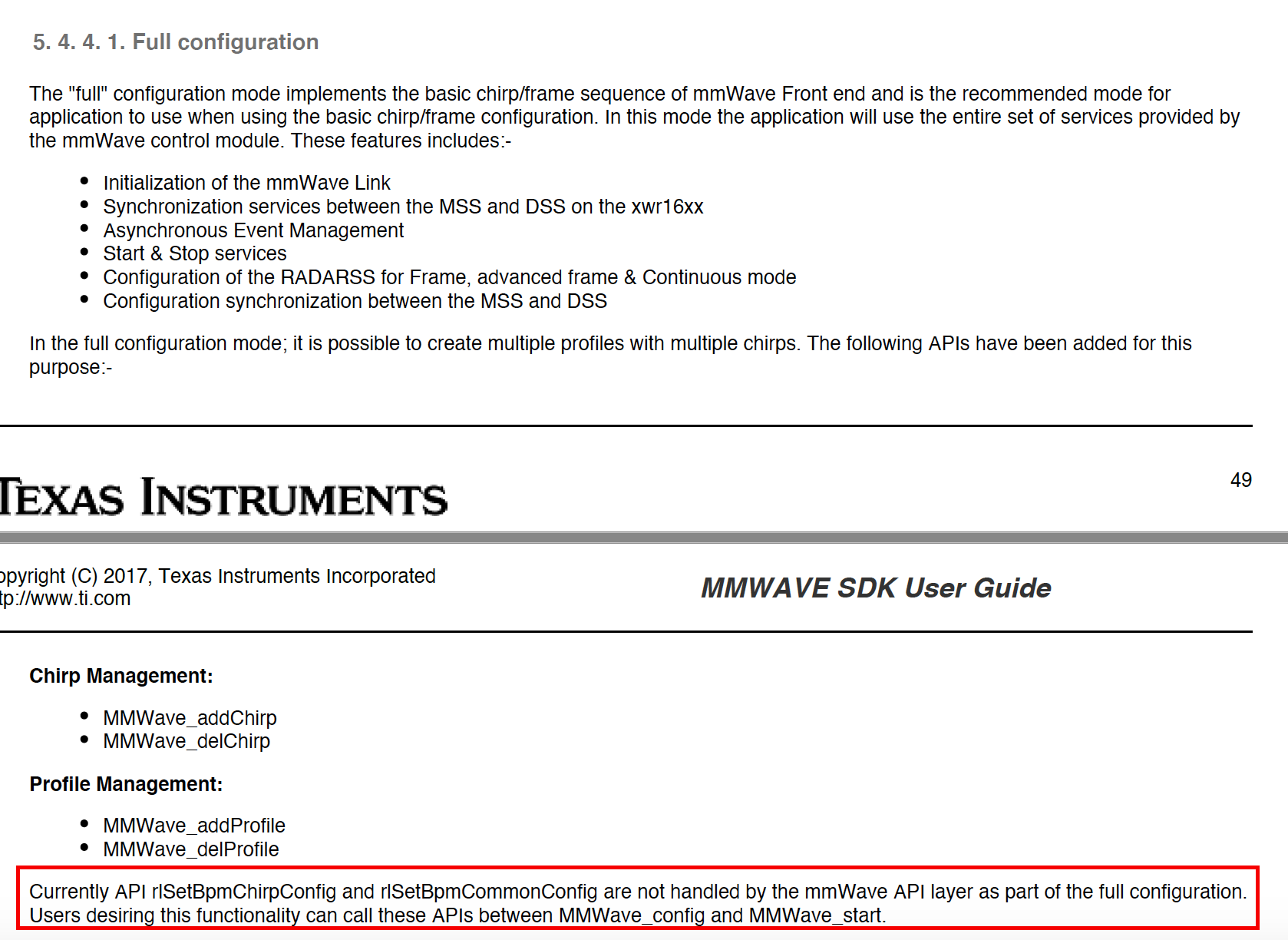

Hi there,
In the SDK, it mentions there is a difference between "full" configuration and "minimal" configuration, as noted below in the screenshot... what is the difference between the two?
Is the difference like: minimal = configuration through CLI command line, while full configuration is through mmwave studio?
Thanks!
George
    Full configuration abstracts the mmwave link APIs used to configure the RF front end from the user. It is easier to use but provides less flexibility.
    Minimal configuration provides the user more flexibility in calling directly the mmWave Link APIs. In this case one needs to have more knowledge about the Link APIs
    thank you
    Cesar
  • Hello George,
    Minimal or Full configuration within mmwave SDK is meant for mmwave library where it requires to configure MSS/DSS and BSS based on selection.
    While mmwave studio is totally different  where you can select which are configuration you need to invoke to mmwave sensor over SPI interface.
     Now in the above snapshot, marked statement means that if you need to use BPM (rlSetBpmChirpConfig and rlSetBpmCommonConfig) then call it outside of mmwave, directly from application.
    Note: rlSetBpmChirpConfig API and rlSetMultiBpmChirpConfig are almost same. rlSetMultiBpmChirpConfig API uses multiple set of rlBpmChirpCfg_t structure within single API call, whereas rlSetBpmChirpConfig needs to call multiple times.
    Jitendra

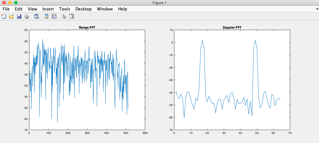

  • Hi Cesar,
    Goal: To transmit a sequence of [0 0 1 1] BPM chirps on one transmitter. I have two other radars transmitting [0 0 0 0] and [0 1 0 1], where I can use both the regular bpmCfg config command in the 16xx profile and only enable a certain Tx path to get one Tx to transmit.
    Therefore, for the [0 0 1 1], I tried to change the bpmCfg command on the CLI to take 4 inputs and change the bpmCfg API in mss_main.c to call the API MMWave_addBpmChirp 4 times to send the bpm chirps to the BSS. And I was able to run it through with no errors thrown (all data was collected, etc.), but unfortunately it seemed like the BSS was not updated with my new BPM scheme.  I performed the decoding and analysis on the data to check if my [0 0 1 1] worked, but it turns out that the scheme out of the 1st Tx no matter what is [0 0 0 0] and out of Tx2 it is [0 1 0 1] regardless of the bpmChirpCfg.constBpmVal I initialized the chirp to be. Please reference this thread to understand more, even though this thread is discussing the idea of extending the chirps. https://e2e.ti.com/support/tools/ccs/f/81/t/931205?tisearch=e2e-sitesearch&keymatch=bpmChirpCfg.constBpmVal%2520%253D%25200xCU%253B
    Therefore, I am thinking of using the BPM Advanced config API to accomplish my goal. Additionally, I have an AWR1843 also if that increases your options to help me accomplish my goal.
    Thanks!
    George
  • I understand,
    I looked at the demo, and I think that the demo was "hard coded" to support only the alternate pattern. So, I think that the implementation of the bpm command in the demo must be modified. It is not a matter of BPM Advanced config
    The following function in C:\ti\mmwave_sdk_02_01_00_04\packages\ti\demo\xwr16xx\mmw\mss\mss_main.c must be modified.
    MmwDemo_bpmConfig()
    In the SDK implementation this function forces the alternate pattern.
    Would it be possible for you to review this function?
    thank you
    Cesar

  • Hi Cesar,
    Thank you for taking a look at my code. And yes, I agree about how a frame is built chirpMin to chirpMax.
    When I ran the BIN file made up of the other .c codes I sent you a few posts before, I used the below CLI script, where I changed the frameCfg to go from 0 to 3.
    sensorStop
    flushCfg
    dfeDataOutputMode 1
    channelCfg 15 2 0
    adcCfg 2 1
    adcbufCfg -1 0 0 1 0
    profileCfg 0 77 7 7 160 0 0 25 1 512 6200 0 0 30
    chirpCfg 0 0 0 0 0 0 0 2
    chirpCfg 1 1 0 0 0 0 0 2
    chirpCfg 2 2 0 0 0 0 0 2
    chirpCfg 3 3 0 0 0 0 0 2
    bpmCfg -1 1 0 1 2 3
    frameCfg 0 3 16 120 250 1 0
    lowPower 0 1
    guiMonitor -1 0 0 0 0 0 0
    cfarCfg -1 0 2 8 4 4 0 5120
    cfarCfg -1 1 0 8 4 4 0 5120
    peakGrouping -1 1 0 0 1 224
    multiObjBeamForming -1 0 0.5
    calibDcRangeSig -1 0 -5 8 256
    extendedMaxVelocity -1 0
    clutterRemoval -1 0
    compRangeBiasAndRxChanPhase 0.0 1 0 1 0 1 0 1 0 1 0 1 0 1 0 1 0
    measureRangeBiasAndRxChanPhase 0 1.5 0.2
    nearFieldCfg -1 0 0 0
    CQRxSatMonitor 0 3 4 127 0
    CQSigImgMonitor 0 63 8
    analogMonitor 0 0
    lvdsStreamCfg -1 0 1 0
    sensorStart
    What is our next step?

        /* Populate configuration: */
        cfg.isHeaderEnabled = (bool) atoi(argv[2]) ;
        cfg.dataFmt         = (uint8_t) atoi(argv[3]) ;
        cfg.isSwEnabled     = (bool) atoi(argv[4]) ;
        /* Save Configuration to use later */
        MmwDemo_mssCfgUpdate((void *)&cfg, offsetof(MmwDemo_CliCfg_t, lvdsStreamCfg),
            sizeof(MmwDemo_LvdsStreamCfg), subFrameNum);
        message.type = MMWDEMO_MSS2DSS_LVDSSTREAM_CFG;
        message.subFrameNum = subFrameNum;
        memcpy((void *)&message.body.lvdsStreamCfg, (void *)&cfg, sizeof(MmwDemo_LvdsStreamCfg));
        if (MmwDemo_mboxWrite(&message) == 0)
            return 0;
        else
            return -1;
     *  @b Description
     *  @n
     *      This is the CLI Execution Task
     *  @retval
     *      Not Applicable.
    void MmwDemo_CLIInit (void)
        CLI_Cfg     cliCfg;
        char        demoBanner[256];
        uint32_t    cnt;
        /* Create Demo Banner to be printed out by CLI */
        sprintf(&demoBanner[0],
                           "******************************************\n" \
                           "xWR16xx MMW Demo %02d.%02d.%02d.%02d\n"  \
                           "******************************************\n",
                            MMWAVE_SDK_VERSION_MAJOR,
                            MMWAVE_SDK_VERSION_MINOR,
                            MMWAVE_SDK_VERSION_BUGFIX,
                            MMWAVE_SDK_VERSION_BUILD
        /* Initialize the CLI configuration: */
        memset ((void *)&cliCfg, 0, sizeof(CLI_Cfg));
        /* Populate the CLI configuration: */
        cliCfg.cliPrompt                    = "mmwDemo:/>";
        cliCfg.cliBanner                    = demoBanner;
        cliCfg.cliUartHandle                = gMmwMssMCB.commandUartHandle;
        cliCfg.taskPriority                 = 3;
        cliCfg.mmWaveHandle                 = gMmwMssMCB.ctrlHandle;
        cliCfg.enableMMWaveExtension        = 1U;
        cliCfg.usePolledMode                = true;
        cnt=0;
        cliCfg.tableEntry[cnt].cmd            = "sensorStart";
        cliCfg.tableEntry[cnt].helpString     = "[doReconfig(optional, default:enabled)]";
        cliCfg.tableEntry[cnt].cmdHandlerFxn  = MmwDemo_CLISensorStart;
        cnt++;
        cliCfg.tableEntry[cnt].cmd            = "sensorStop";
        cliCfg.tableEntry[cnt].helpString     = "No arguments";
        cliCfg.tableEntry[cnt].cmdHandlerFxn  = MmwDemo_CLISensorStop;
        cnt++;
        cliCfg.tableEntry[cnt].cmd            = "guiMonitor";
        cliCfg.tableEntry[cnt].helpString     = "<subFrameIdx> <detectedObjects> <logMagRange> <noiseProfile> <rangeAzimuthHeatMap> <rangeDopplerHeatMap> <statsInfo>";
        cliCfg.tableEntry[cnt].cmdHandlerFxn  = MmwDemo_CLIGuiMonSel;
        cnt++;
        cliCfg.tableEntry[cnt].cmd            = "cfarCfg";
        cliCfg.tableEntry[cnt].helpString     = "<subFrameIdx> <procDirection> <averageMode> <winLen> <guardLen> <noiseDiv> <cyclicMode> <thresholdScale>";
        cliCfg.tableEntry[cnt].cmdHandlerFxn  = MmwDemo_CLICfarCfg;
        cnt++;
        cliCfg.tableEntry[cnt].cmd            = "peakGrouping";
        cliCfg.tableEntry[cnt].helpString     = "<subFrameIdx> <groupingMode> <rangeDimEn> <dopplerDimEn> <startRangeIdx> <endRangeIdx>";
        cliCfg.tableEntry[cnt].cmdHandlerFxn  = MmwDemo_CLIPeakGroupingCfg;
        cnt++;
        cliCfg.tableEntry[cnt].cmd            = "dataLogger";
        cliCfg.tableEntry[cnt].helpString     = "<mssLogger | dssLogger>";
        cliCfg.tableEntry[cnt].cmdHandlerFxn  = MmwDemo_CLISetDataLogger;
        cnt++;
        cliCfg.tableEntry[cnt].cmd            = "multiObjBeamForming";
        cliCfg.tableEntry[cnt].helpString     = "<subFrameIdx> <enabled> <threshold>";
        cliCfg.tableEntry[cnt].cmdHandlerFxn  = MmwDemo_CLIMultiObjBeamForming;
        cnt++;
        cliCfg.tableEntry[cnt].cmd            = "calibDcRangeSig";
        cliCfg.tableEntry[cnt].helpString     = "<subFrameIdx> <enabled> <negativeBinIdx> <positiveBinIdx> <numAvgFrames>";
        cliCfg.tableEntry[cnt].cmdHandlerFxn  = MmwDemo_CLICalibDcRangeSig;
        cnt++;
        cliCfg.tableEntry[cnt].cmd            = "extendedMaxVelocity";
        cliCfg.tableEntry[cnt].helpString     = "<subFrameIdx> <enabled>";
        cliCfg.tableEntry[cnt].cmdHandlerFxn  = MmwDemo_CLIExtendedMaxVelocity;
        cnt++;
        cliCfg.tableEntry[cnt].cmd            = "clutterRemoval";
        cliCfg.tableEntry[cnt].helpString     = "<enabled>";
        cliCfg.tableEntry[cnt].cmdHandlerFxn  = MmwDemo_CLIClutterRemoval;
        cnt++;
        cliCfg.tableEntry[cnt].cmd            = "adcbufCfg";
        cliCfg.tableEntry[cnt].helpString     = "<subFrameIdx> <adcOutputFmt> <SampleSwap> <ChanInterleave> <ChirpThreshold>";
        cliCfg.tableEntry[cnt].cmdHandlerFxn  = MmwDemo_CLIADCBufCfg;
        cnt++;
        cliCfg.tableEntry[cnt].cmd            = "compRangeBiasAndRxChanPhase";
        cliCfg.tableEntry[cnt].helpString     = "<rangeBias> <Re00> <Im00> <Re01> <Im01> <Re02> <Im02> <Re03> <Im03> <Re10> <Im10> <Re11> <Im11> <Re12> <Im12> <Re13> <Im13> ";
        cliCfg.tableEntry[cnt].cmdHandlerFxn  = MmwDemo_CLICompRangeBiasAndRxChanPhaseCfg;
        cnt++;
        cliCfg.tableEntry[cnt].cmd            = "measureRangeBiasAndRxChanPhase";
        cliCfg.tableEntry[cnt].helpString     = "<enabled> <targetDistance> <searchWin>";
        cliCfg.tableEntry[cnt].cmdHandlerFxn  = MmwDemo_CLIMeasureRangeBiasAndRxChanPhaseCfg;
        cnt++;
    // George edited this to include 2 more chirp indexes
        cliCfg.tableEntry[cnt].cmd            = "bpmCfg";
        cliCfg.tableEntry[cnt].helpString     = "<subFrameIdx> <enabled> <chirp0Idx> <chirp1Idx> <chirp2Idx> <chirp3Idx>";
        cliCfg.tableEntry[cnt].cmdHandlerFxn  = MmwDemo_CLIBpmCfg;
        cnt++;
        cliCfg.tableEntry[cnt].cmd            = "nearFieldCfg";
        cliCfg.tableEntry[cnt].helpString     = "<enabled> <startRangeIndex> <endRangeIndex>";
        cliCfg.tableEntry[cnt].cmdHandlerFxn  = MmwDemo_CLINearFieldCorrection;
        cnt++;
        cliCfg.tableEntry[cnt].cmd            = "CQRxSatMonitor";
        cliCfg.tableEntry[cnt].helpString     = "<profile> <satMonSel> <priSliceDuration> <numSlices> <rxChanMask>";
        cliCfg.tableEntry[cnt].cmdHandlerFxn  = MmwDemo_CLIChirpQualityRxSatMonCfg;
        cnt++;
        cliCfg.tableEntry[cnt].cmd            = "CQSigImgMonitor";
        cliCfg.tableEntry[cnt].helpString     = "<profile> <numSlices> <numSamplePerSlice>";
        cliCfg.tableEntry[cnt].cmdHandlerFxn  = MmwDemo_CLIChirpQualitySigImgMonCfg;
        cnt++;
        cliCfg.tableEntry[cnt].cmd            = "analogMonitor";
        cliCfg.tableEntry[cnt].helpString     = "<rxSaturation> <sigImgBand>";
        cliCfg.tableEntry[cnt].cmdHandlerFxn  = MmwDemo_CLIAnalogMonitorCfg;
        cnt++;
        cliCfg.tableEntry[cnt].cmd            = "lvdsStreamCfg";
        cliCfg.tableEntry[cnt].helpString     = "<subFrameIdx> <enableHeader> <dataFmt> <enableSW>";
        cliCfg.tableEntry[cnt].cmdHandlerFxn  = MmwDemo_CLILvdsStreamCfg;
        cnt++;
        /* Open the CLI: */
        if (CLI_open (&cliCfg) < 0)
            System_printf ("Error: Unable to open the CLI\n");
            return;
        System_printf ("Debug: CLI is operational\n");
        return;

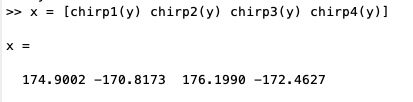

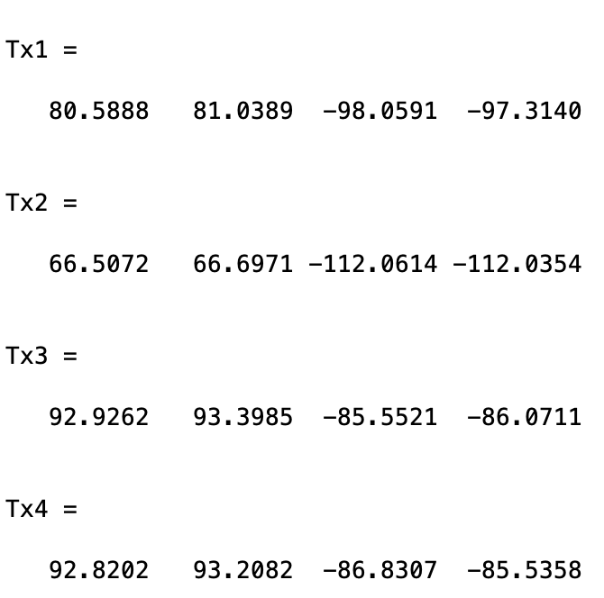

  • Hi Kyle and Cesar,
    Thank you for running the above test cases and getting back to me. There are a few things I am noticing, discussed below, that I am concerned about.
    Correct me if I am wrong, but the Chirp RAM (where you are looking) is located before the BSS, correct? I honestly still think that while the chirp RAM has the correct configuration, the BSS is still not either 1) not receiving that configuration or 2) not updating the front end with with the correct configuration to transmit. Here is why:
    - To confirm everything transmitted correctly, I changed the constBpmVal to 0U for all 4 chirps. I then ran a test with a corner reflector to see if there is no phase change across samples in consecutive chirps. Unfortunately, below show four screenshots, which depict the degrees I received for chirp 9-12 from Tx1, Tx2, Tx3, and Tx4. (**Assume indexes for the BPM decoding block is chirp1-chirp4**). I calculated these values by taking rad2deg(complex ADC samples) received at each receiver.
    Rx 1:
    Rx 2:
    Rx 3:
    Rx 4:
    As you can see, the same samples across chirps (independent of Rx) are not 0 degrees. Is there a particular reason why you would say that the chirps in the RAM are not being transmitted with the correct phase shift?
    If you look closer, chirp 1 and chirp 3 for Rx 1 and 3 were relatively 180 degrees apart from chirp 2 and chirp 4 on Rx 1 and 3. But for Rx 2 and Rx 4, they are about 21 deg off. Why would you say they are not consistent?
    Furthermore, as you look in the spatial domain (rather than the time domain -- across chirps) across Rx for the same chirp, there is weird things happening across Rx's. Regardless of BPM, shouldn't we expect the degrees received on the same Rx to be the same across chirps (since the corner reflector is directly in front of the radar)? There is another weird pattern.
    Thanks and I look forward to hearing your thoughts on these issues!
    George

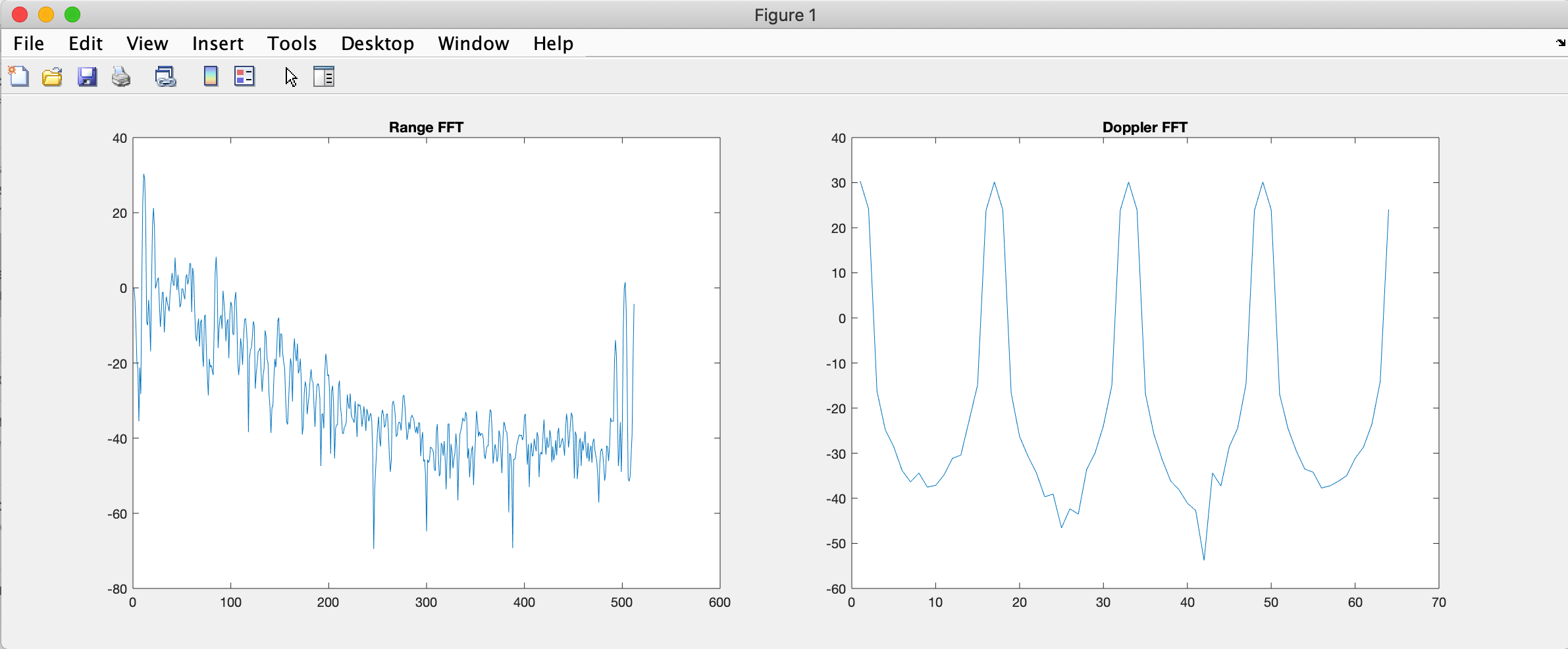

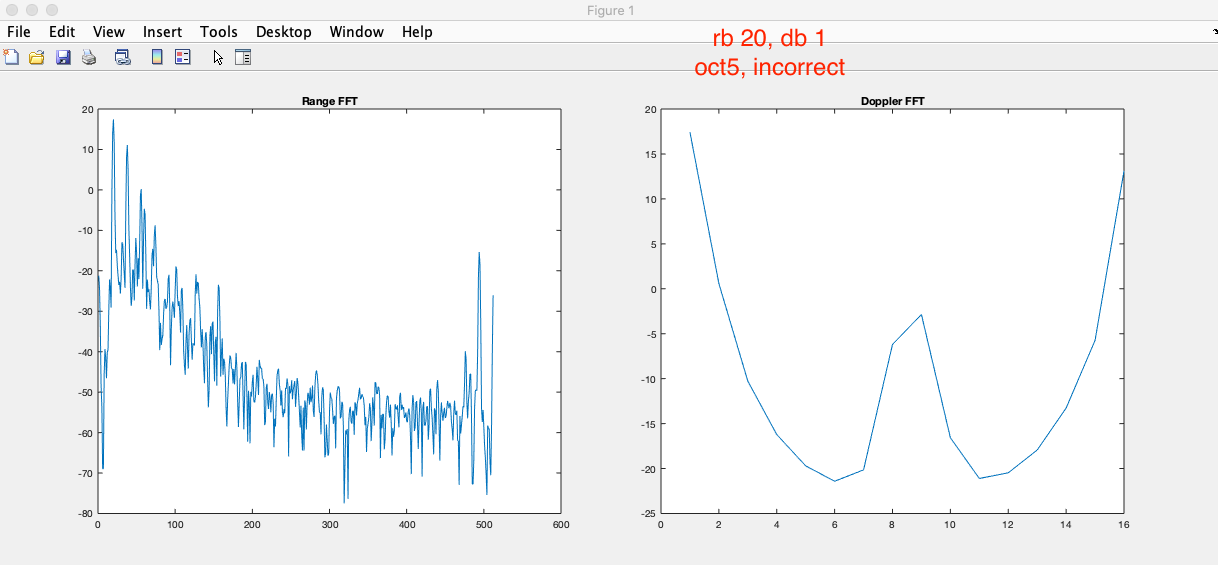

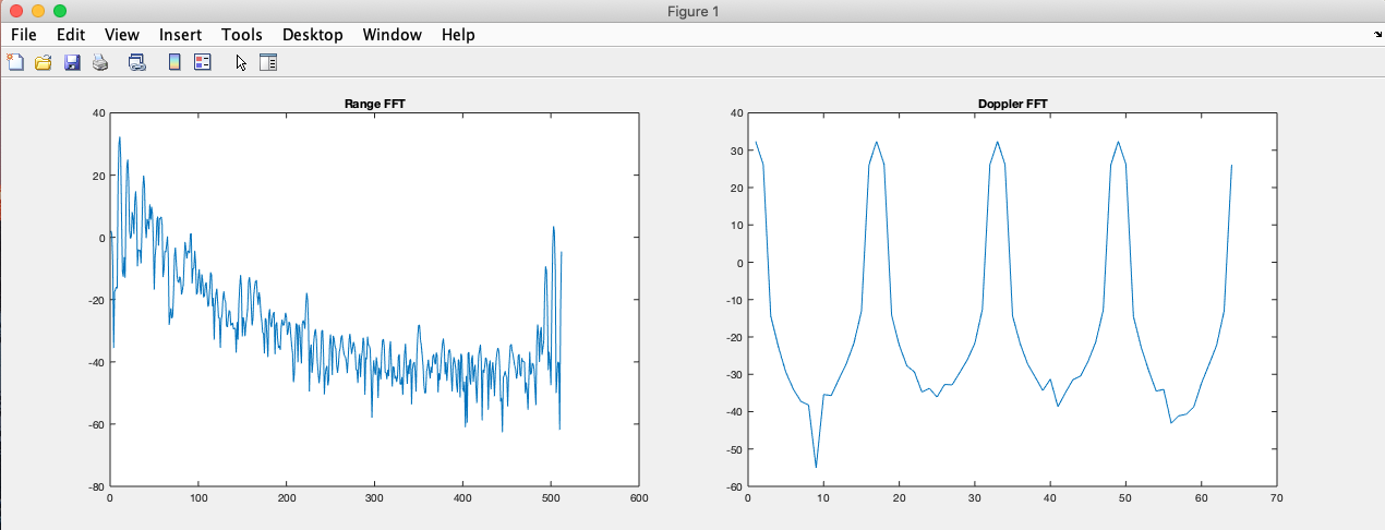

  • Hi Cesar,
    Great, thank you for working with the team to help me solve this issue. I really appreciate the help!
    You may also tell the team that as of yesterday morning, I received the desired BPM sequence (not the default [01] bpm sequence) as seen in screenshots below similar to my last post by using bpmCfgAdvanced in the Advanced Frame Mode. BUT, the received power for the 180deg BPM phase shifted chirps was in the negative dB. I worked all yesterday trying to figure out why. Please see the screenshots below confirming the sequence, but also the very low power. I have also attached the CLI script that I used to configure the AWR1642. If I can understand why the received power is so low and fix it, it seems like everything should work out.
    Chirp Sequence: [chirp1 chirp2 chirp3 chirp4], where the values shown are received adc samples converted from complex numbers to degrees.
    Range and Doppler FFT over all samples (no decoding):
    Info for below graph: range_bin = 12; doppler_bin = 1; frameIndex = 20; rx_num = 1;
    Range and Doppler FFT across a range bin (Pre-decoded) with low power:
    Info for below graph: range_bin = 16; doppler_bin = 4; frameIndex = 20; rx_num = 1;
    Also, for evidence that my code works, I have attached below plots for the monostatic (0 deg phase shift for all chirps) case using the same MATLAB code:
    CLI Script used:
    sensorStop
    flushCfg
    dfeDataOutputMode 3
    channelCfg 15 3 0
    adcCfg 2 1
    profileCfg 0 77 7 7 160 0 0 20 1 512 6200 0 0 30
    chirpCfg 0 0 0 0 0 0 0 1
    chirpCfg 1 1 0 0 0 0 0 1
    chirpCfg 2 2 0 0 0 0 0 1
    chirpCfg 3 3 0 0 0 0 0 1
    advFrameCfg 1 0 60 1 0
    subFrameCfg 0 0 0 4 16 100 0 1 1 100
    bpmCfgAdvanced 0 1 0
    bpmCfgAdvanced 2 3 3
    lowPower 0 1
    clutterRemoval -1 0
    analogMonitor 0 0
    sensorStart
    Collected and Processed Data for above screenshots Attached as excel file: bpm_0011_BTxE.csv
    MATLAB code to plot these samples and print out the BPM scheme: 5102.check_transmission.pdf
    Looking forward to hearing all advice and recommendations you and your team have as soon as you have them. As always, keep sending questions when they pop up. Have a great day!
    George
    As a follow up, I have noticed a few additional observations after doing more testing today that may help us all come to some answer as to how to make this all work:
    1) The spikes in the graph may depend on how many bpm chirps there are in the sequence:
    Ex: Sequence [00110010]
    Exception: when I do all 0's, and still do bpmCfgAdvanced (but put the constBpmVal to 0), I get the below. No spikes... Also, all chirps in the 4 chirp sequence are the same degrees (ref. note #3)
    2) Maybe the FFT does some sort of cancelation to the 0011 signal (screenshot in previous thread reply) since I ran a 0010 test and I got the below graph. I am thinking the chirp 3 and chirp 4 are canceled and chirp 1 and 2 make up the very positive power, normal looking doppler FFT and Range FFT (disregard spikes).
    3) Since the all 0's exception worked (no spikes, high powered FFTs, and chirps that all correlate), I tried bpmCfgAdvanced where all 4 chirps have a 1. This was weird because I got the below graph and the below set of chirps.... If you look at the chirps, only 3 correlate to each other, and the fourth, usually the first one in the sequence/resolution block, is phase shifted differently than the others (which is not what I configured). Also, notice that the FFTs are very positive which proves maybe one was phase shifted (canceled with another through FFT operation?) then plotted two non canceling [11] chirps or [00] chirps (if the first chirp is the only one phase shifted).... I am unsure...
    George
