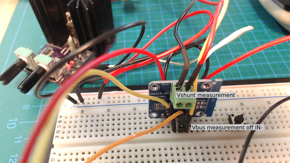

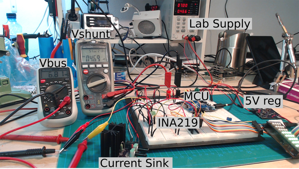

    It will take me a little longer to get around to making the measurements you suggest. In the mean time, I figure a picture is worth a thousand words so I have made a couple of photos to show the setup. Basically the Vbus is measured off the terminals provided on the INA219 breakout board. The IN+ and IN- that come in from the supply and go out to the load are connected via the connectors on the breadboard.  The only current reading is only taken from the Lab power supply.
    I was actually wondering if this could be temperature related. What made me so unsure is that the breakout board and example claim to be capable of up to 32V and 2A. It has a Rshunt of 0.1Ω 1% 2W. From my calculations, the maximum power to be dissipated through Rshunt is 0.4W.
    I will post again when I have the additional results.
    Thanks again for your time.

    Thanks again for your reply. I worked through your steps again. The results show that the temperature has no significant impact on the results of this issue. However, your other theory of the "GND loading" seems to be correct. I have two supply buses - one for 5V and the other for 7V. The IN+ on the INA219 is supplied from the 7V bus. IN- goes to the Current Sink. The ground line is then (lazily) connect near the INA219 - on the 5V bus GND. When I moved the Current Sink ground onto the 7V bus, the results were significantly  better. There are still some elements of error but well and truly in the ball-park and stay linear throughout.
    The connections are best shown in some diagrams. The first diagram shows how it was connected and returning the odd results. The second shows the corrected connections that provide the expected results.
    The final results are much more as to what I was expecting form the start.
    Thanks again for your suggestions. I will now be reading up on "Ground Loading". I have heard of this issue before but this is the first time I have experienced this first hand.
