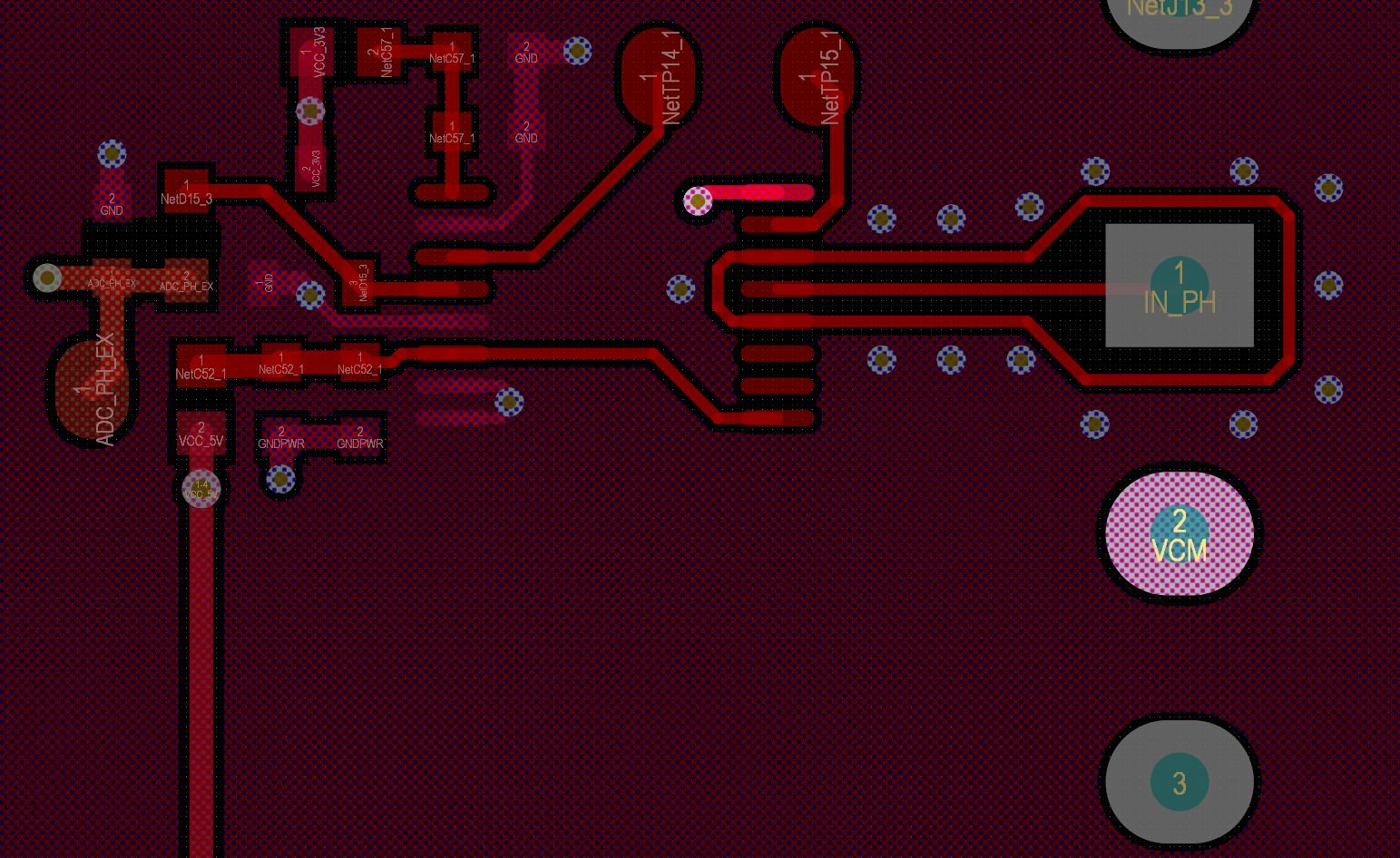

Hi everyone.
I had designed schematic using LMP91200 to communicate with PH sensor.
try to change PH value but ADC value i read not change.
i have probe at the pin INP of PH sensor, when i don't plug in PH sensor it is 1.6V and Vout is same Vin, i can't understand why it is 1.6V when i don't plugin PH sensor.
when i plugin Vin PH is 1.73, and Vout is 1.73?
Schematic and layout as bellow.
how i can calculate and measure PH value?
but it not successful.

    I would remove/DNI the BAV199 part from your schematic. Also, what is the number of your sensor? - might want to put that on your drawing, next to the connector - that you should consider changing to use triax cable.
    Also, perhaps consider connecting the VOCM output to another ADC channel and characterize, or adjust/remove the R47 and C54 as required by your MCU ADC.

    Perhaps i see it now - shouldn't your guard and VCM traces be at same potential - looks like you may have not connected them  - see the LMP91200 EVM schematic here to refer to. https://www.ti.com/lit/ml/snau122a/snau122a.pdf (page 6)
    then also make sure you have checked out this from the probe vendor, too - in case you modified the cable - as from them it should have SMA connector with an SMA to BNC adapter. https://www.atlas-scientific.com/files/pH_probe.pdf

    i'm not understand about "shouldn't your guard and VCM traces be at same potential - looks like you may have not connected them", because i have traced VCM and Guard in difference layer, can you explain more a bout it?
    In my case, i'm not modified cable, i only change BNC adapter to SMA.

    Sorry, you are correct, the Active Guard pins should be at same potential as the INP pin. Please see section 10.1 in the LMP91200 datasheet (page 17) for the complete explanation.
    And if you have a look at pages 6 and 7 here, you can see how our EVM is laid out and copy that. https://www.ti.com/lit/ml/snau122a/snau122a.pdf

      I have looked over your schematic and layout. I don't see anything wrong.
    Check your board for cleanliness, make sure there is no flux residue on the board. These probes operate in the uA range and any contaminates will cause problems. Make sure after cleaning that you bake the boards to drive out moisture. even condensation will effect the probe.
    Also can you try another probe in case this one has a problem?
