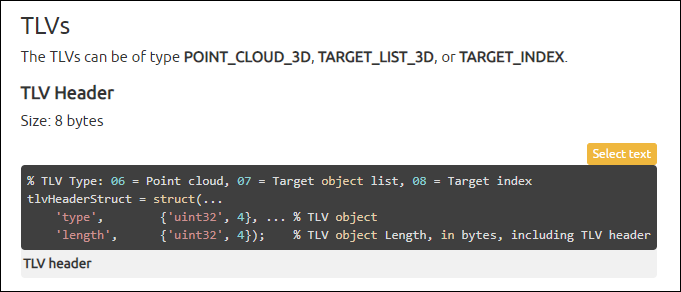

I have binary data, which is available in people count document. i want to identify the data from that binary frame. here i am attaching data format screenshot. i want to know, how the data is captured. for example here we took people count scenario. how people is counting using mmwave sensor and TLV's is formed. in the screenshot the data is repeated it means number of objects. what is the mean of point_cloud, target_objects and target_index. i am attaching one more screenshot that is my assumption, is this right way to represent. Please do the needful.

    Wonder if you have already looked at this guide that calls out the details of TLV size
    Data Formats
    You may have to reverse compute the count based on tlv size.
    If you look at the algorithm details it would show that:
    Point cloud :  input to the tracker.
    Target list : Out put of tracker.
    Another way to look at how data is parsed is to see the  python gui code which may provide insights to this.

  • Hi Srikanth,
    You have not indicated which particular people counting demo you are looking at. But each demo has clear description of the output stream including the message header and description of the individual TLVs, with the actual data structures as shown below. These definitions and the parsing code implented in the python GUI should be a complete reference on how to interpret the output stream.
    and so on...
    -Nitin
