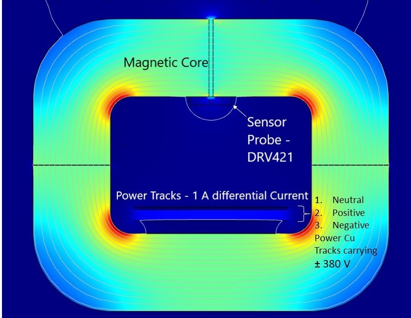

                                                                             Fig 1: Geometry used for 2D modeling of Nanocrystalline racetrack shaped magnetic core in COMSOL Multiphysics 5.3 b.
                                                                           Fig 2: Simulation result with a 1 A differential current - Positive Cu trace carrying +11 A and Negative Cu track carrying -10 A respectively and 0A in Neutral.
We get - 360 - 410 µT/A on the "Probe" considered within  the DRV421 PCB. The probe considered is 0.4 mm length and 0.3 mm height sitting within a 0.8 x 4 mm DRV421 sensor.

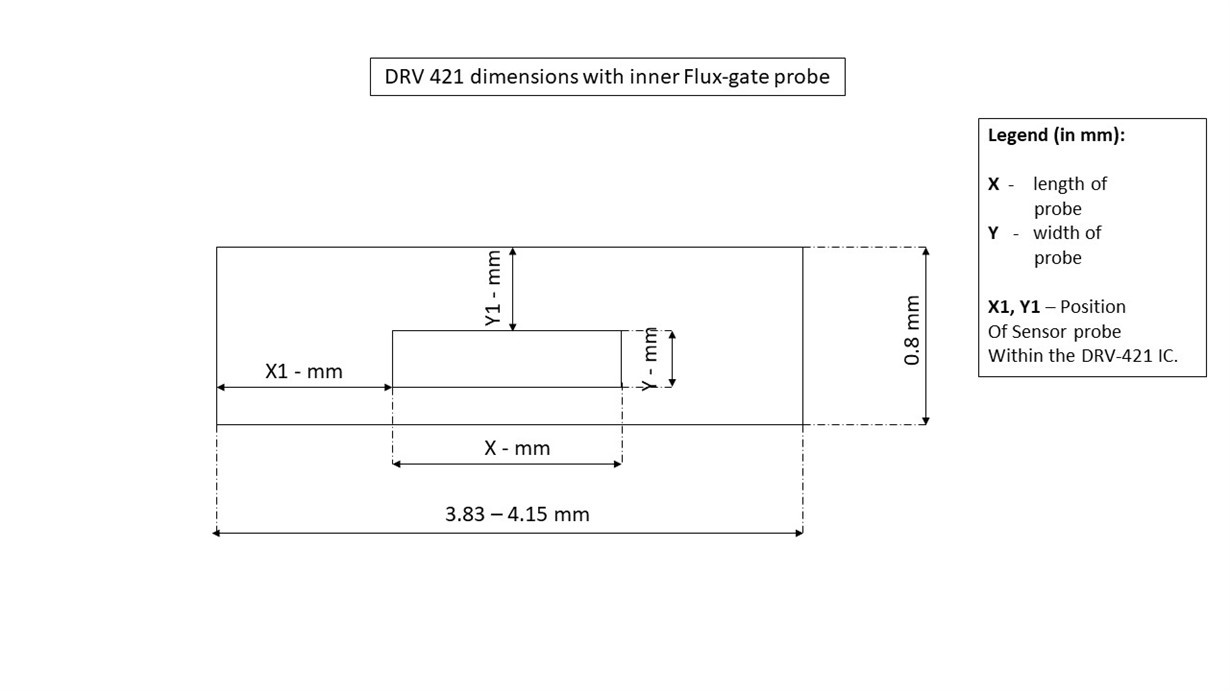

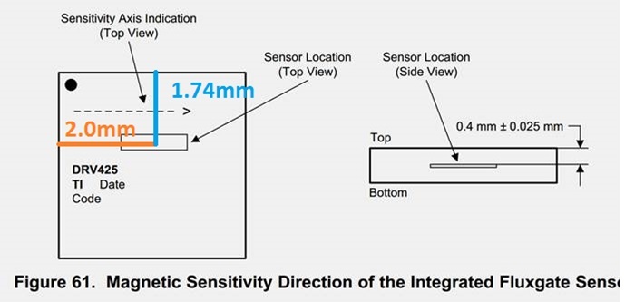

1.    What is the position of the 'Probe' (Fluxgate Front-end sensor) within the Fluxgate IC ? This is requested by us for an accurate simulation on COMSOL. An image representation of what I ask is below:
                                                     Fig 3:  What is the length of probe 'X' and width 'Y' and it's position within the IC:  'X1 , Y1' .

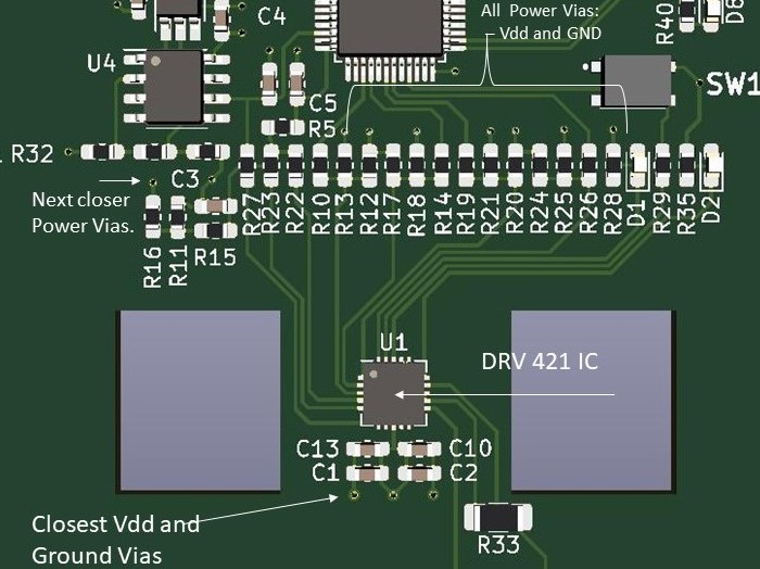

4.      There are around 38 VDD (3.3 V) and Ground vias on the top layer atleast with a distance of 3  - 11 mm from the DRV421 IC. An image is shown below:
Is it advisable to keep these many vias on the same layer as the DRV 421 , it being very sensitive to stray magnetic flux ?  Also , there are Ground and Vdd (3.3 V) planes just below the top layer. Is this advisable also ? As the currents passing on the ground plane will have magnetic flux perpendicular to the DRV 421 (not along its sensitive axis) but the Vias might have flux along the sensing direction.
Should I preferably keep the vias as far as possible from the DRV IC ?

    From the simulations we could see that for 20 mA case, we are only able to obtain around 16 - 19 µT for  20 mA
    Will this sensitivity be enough for good detection or we must have atleast 200 µT for 20 mA for e.g. to have the best chance at proper and accurate detection?
    For shielding we are considering to use a Steel cube enclosing atleast a part of PCB like a cage, only allowing 2 or 5 holes for the input power.
    The shielding has not yet been simulated but any advice for this design would be very good.

    1. Here is a diagram of the location of the sensor location it is the same location as the DRV425.   The angle can vary a couple of degrees but for a close loop system this will not impact as the coupling from primary and compensating current are through the core.
    2. I cannot give that information out and and the area is small in the package that it will not disturb the field seen.  You can simulate it as a point at location mentioned above.

    4. When measuring low fields the current for VDD will matter but it does depend on the routing under the sensor and the current density at that point.  For example if you have a trace centered under DRV425 going right through the center this would be a greater error than a place where the current is distributed.  I think this could be an error but would likely be in the range of the offset of the flux gate.]

    4. Thank you for explaining this as there are more Vdd and GND vias linking to bottom layers at many locations on the pcb top layer.
         But there are no traces routed directly underneath the DRV421 on any layer as passing directly through the centre. I think this is what you meant would
         cause the error ?  All the tracks connect to the pins of the DRV 421. I am concerned of the vias as there might be as you explained a horizontal

    4. Thank you for explaining this as there are more Vdd and GND vias linking to bottom layers at many locations on the pcb top layer. But there are no traces routed directly underneath the DRV421 on any layer as passing directly through the centre. I think this is what you meant would cause the error ?
    This is correct as traces/current would be the closest to the DRV421 causing a magnetic field. If the return current is in the same proximity it will cancel out.
    All the tracks connect to the pins of the DRV 421. I am concerned of the vias as there might be as you explained a horizontal flux in direction of the line of sensitivity of the sensor. If the offsets due to the flux caused by these vias are 8 µT each, then won't it be a large offset on the sensor output ? along with the internal 8 µT offset ?
    The vias are where the current can concentrate if you have planes supplying both the VDD and GND but you need to look at the distance from the sensor to see the error it can cause. If you place the GND (return current) in the same proximity they will cancel each other out when they are equal. They should be equal for the most part.

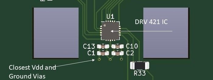

    Thank you for the reply. I am working on the Degauss. There were two more questions I wished to ask you :
    1.] In the image below , I have placed the filtering capacitances C13, C10, C1, C2 very close to the sensor terminals (around 0.2 mm) which will come under the magnetic core's air gap of 0.2 - 0.3 mm. Should I place these capacitors a bit farther from the core ? How far is ideal ? Will it affect the sensing in the DRV 421 if placed very close to it's terminals? In the datasheet under "Layout Example" , the image, Capacitors are be placed very close to the sensor terminals. While it also says "Keep area free of any components creating magnetic field".
    2.]  The Shunt resistor (Rshunt) you can see in the image above R33 is 1206, around 5 - 10 kilo ohms or lesser. Due to availability of only 0603 resistors currently with us,  can I  use two or more 0603 resistors in series to create the same amount of Vout created by the Rshunt of 1206 series ? Is it highly recommended to use 1206 resistor as shown under "Layout Example" (pg. 36) ? Due to availability reasons we are using 0603 resistor. Kindly let me know if this is a good idea.
    3.]   A small doubt regarding "Compensation Windings" around the Magnetic Core:
           We are using a 4 - Layer PCB of 0.8 mm thickness.
            We are having 56 turns on the exterior sides and 51 - 52 turns on the Inner Layers.
            In total  -  214 - 216 compensation turns per PCB.
            The core as I had mentioned before is a Rectangular (Racetrack Core ) and will have the planar windings on the shorter limbs.
            As per your experience, would it be good to have windings on "Both the Core limbs" meaning Split the windings per layer on two core limbs ?
           I currently have a planar winding only around one limb.
           Will this help reduce any leakage flux and provide better compensation ?
            The operation is in Pure DC and will not have AC of any kind.  Is winding around both cores advisable in this case ?
    4.]     Sir, I just wish to know what is the exact relation between "Higher Flux Density" on DRV 421 and the Output Vout ?
             Will higher flux density only increase the voltage across the windings for better driving capability ?
              Because currently we are able to obtain around 69 - 78 uT  by considering that the "Probe" inside the DRV is iron having relative permeability = 100.
              Kindly advise on this.
              Since the sensor needs to be precise and accurate, I am very worried that the results will have a lot of errors.
              This is the reason I requested for the inner operation and any info. on core inside the DRV 421.  Please advise on the relation between the flux density
               and output. Any example with explanation would do as well.
              We wish to have lesser than 0.1 % error since this device is to be used for detection residual currents. This is the concern.

  • Hello Balaji,
    Here is my reply from the previous questions.  Thanks for being patient.  I will look at your confidential material you sent through email.
    1]
    There are capacitors that have non-magnetic materials. These are the ones that should be used. Please be aware some capacitors state they have non-magnetic materials but after evaluating them I have seen they actually do have material that does have material that has some permeability. If you use some of the capacitors without magnetic material your placement is fine. If you cannot I would move capacitors lower and below the core.
    Also please separate capacitors connection like seen on figure 71 in the datasheet for the capacitors. You should have for example C13, C1 connected to pin 8 and C10,C2 connected to pin 9.
    2]
    The size of the resistor is more due to power constraints. The main design for the DRV421 is for larger currents so the 1206 resistor could matter. The size or resistor is only due to power. With large resistor you could worry about stability. Depending on the inductance and your Rshunt you could have issues. See this application note.
    3]
    From my experience symmetrical is always best. So a core with windings distributed over the whole core windings are better than if the compensation windings were on only one side. Think of this a magnetic coupling. The higher the permeability of you core the less of an issue as all the magnetic coupling happens in the core and the flux does not escape the core. This could be simulated by getting the entire mechanical placement in place and look at the simulation, but the easiest way to approach is to have it symmetrical. Your air gaps I believe will be your biggest issues as these will be hard to control.
    You want to make sure you windings don’t couple magnetically directly to your sensor but couple to your core. This is done by having compensation windings closer to your core and further from the DRV421 sensor. You want all magnetic coupling happening through the core.
    Same as above you want couple through the core. Place an AC filter to the lowest frequency response you can accept. This will reduce some noise.
    4]
    The easiest way to explain this is the DRV421 is pushing current on the compensation winding to place 0 field at the sensor inside the DRV421. There is an offset so you need to take that into account.   As the field increases the DRV421 drives form current on the compensation windings to balance it to zero. Therefore you will have more current on your Rshunt increasing your voltage. The higher the flux density you could think of it as your signal. So having the highest magnetic gain is best.
    This is signal to noise that is going to be an issue. As we go down in signal our noise/offset plays a larger role in our error.
    I cannot give the internal properties of the probe information.
    Like I mentioned before I think this is very difficult to do with the mechanical limitations and magnetic coupling.  0.1% at such a low signal level relative to the offset and noise.  With a core of 500µT/A the offset is 16mA from the offset of 8µT.  You can see that the offset a large part of the error and even if you eliminate the offset the drift, noise, and other changes from ideal near the offset are going to be issues.  Because the sensor cannot get placed closer to the air gap of the core you cannot get much more flux at the sensor and cannot increase the gain much more than the 500µT/A.
