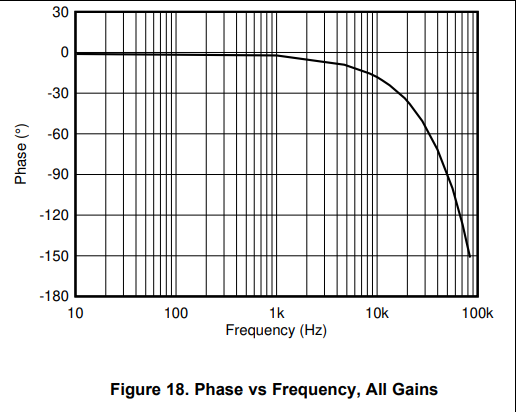

    Aside from the 4us integrator delay, there is phase delay which is as in the graph shown below.

    4b, 4c) Initially I was only considering your fundamental harmonic. For higher frequency harmonics I think the phase plot I shared above should help determine what kind of phase delay you can expect.

    1) Both the transformer and hall sensor will introduce some phase delay. For the TMCS1101, according to the data used to generate the curve above, the phase will rapidly increase for any signal content above 1khz.  As for the transformer, the manufacturer for that transformer may be best able to give you an idea of what to expect and how to minimize it.  Based upon the phase delay you either calculate or determine experimentally, you can use the preload delay or a combination of the preload delay and sample delays.

    3)If you are wanting to capture all the frequency content well above 50Hz, we have several current shunt monitors with higher bandwidth than that of the TMCS1100 or even isolated amplifiers.
