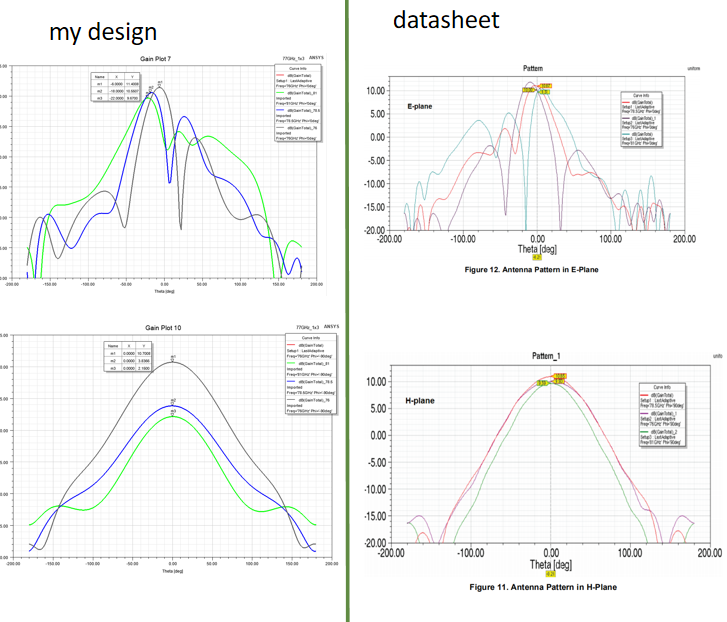

The Gain in 90deg of Phi, my result can't reach 10dB,there is only 2dB at 81GHz.When I use the Dk with 3.25,the gain can up to 10dB but the S11 is wrong,the frequence bandwide up to 79-88GHz

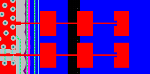

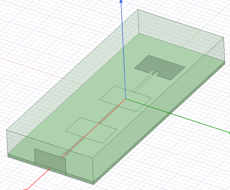

Hello CHETHAN KUMAR Y.B.,
I simulated the PCB antenna of IWR1443BOOST. I want to send my design file,but there seems to be some problems here,the send failed.I put the question here(www.researchgate.net/.../How_to_get_the_right_result_of_iwr1443), can you please go to the website and have a look?
I'm trying to make my design exactly the same as the datasheet.

You cannot change the stack-up thickness of the RO4835LOPRO material generally, This is a core material (not a pre-preg material) which comes with 4mil thick with Cu cladding on both sides. And Cu thickness of ~0.05mm after plating on finished PCB. Use the dielectric constant as specified in the Rogers impedance calculator. Hence stackup details plays very important role.
Also simulation should use GCPW transmission lines structures along with antenna, And port location should be at the edge of the package where GCPW transmission lines starts. 50Ohm reference plane starts there. Simulation should also contain and transmitter and receiver antennas together. There will be coupling effect between Tx and Rx antennas that need to be comprehended.

Lili,
Yes you need to include all the via metal structures, as it is in the EVM.
50 ohm reference plane starts at the edge o the package not at the ball, roughly 2mm after the ball. You need to assign port over there.
