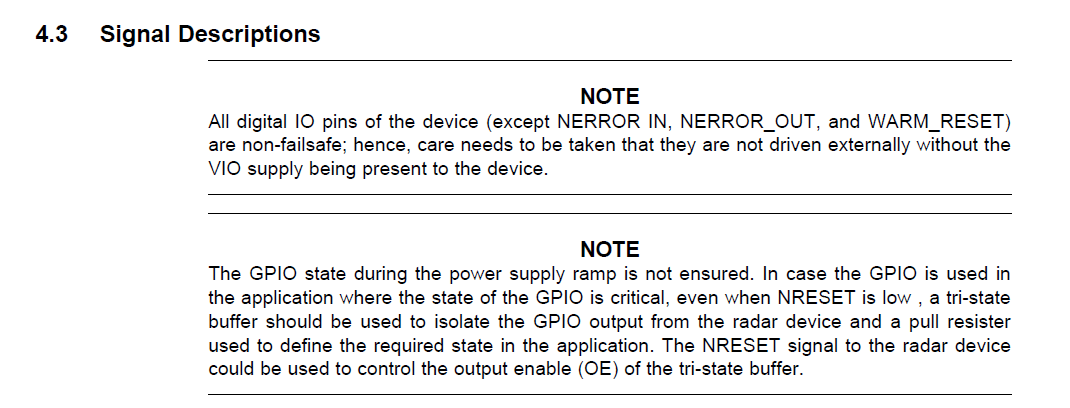

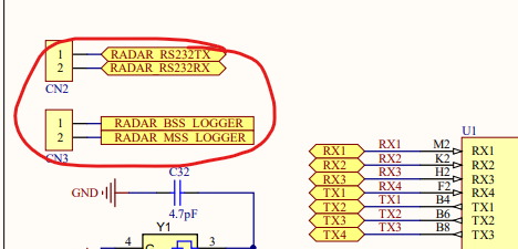

    Cautionary note: Below RS232 and logger pins are connected to external I/O.  These lines should not be driven to the sensor when VIO supply is not present.  This may cause power up problem as well as reliability problem on the mmWave sensor. Please refer to cautionary note from the Datasheet.
