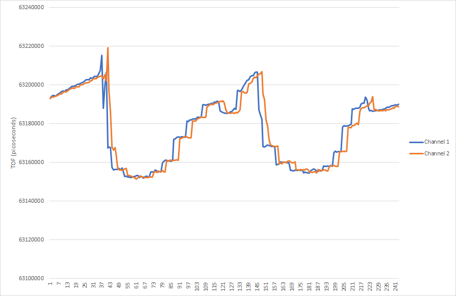

My zero flow and downstream graphis as follows;
my zero flow and upstream graphic as follows;
My attempt to make automatic channel swapping and result graphis as follows;

    The downstream TOF measurement should be shorter than the upstream TOF measurement. Your Config 2 settings (mode 2, CH_SWP, EXT_CHSEL) look fine. Could you please attach the register configuration file (TDC tab ->save CONFIG button) so that I can replicate it?
    I also have some questions about your plots. What is the actual TOF measurement range on your plots? The scale shows 10s of milliseconds. The first plot (downstream and zero flow), does not match what is expected for a downstream plot, since the TOF measurements taken during downstream flow should larger than the zero flow TOF measurements. Can you confirm what the fluid stream is doing in that plot? In the second plot, is there a reason you are seeing that spike over those 8-10 samples?
    If you are able to take measurements on a water stream with a near constant velocity, that would be ideal for testing. You would expect to see two separate flat lines for CH1 and CH2.
    I tought downstream low should smaller then zero flow TOF. Then does it mean it is zero flow and upstream flow?
    The fluid stream in that plot is zero flow and approximately 570l/h water flow see plot below has explanation
    The spikes are happened when I open the valve, same for first plot the rapid changes are happened when I open or close the valve

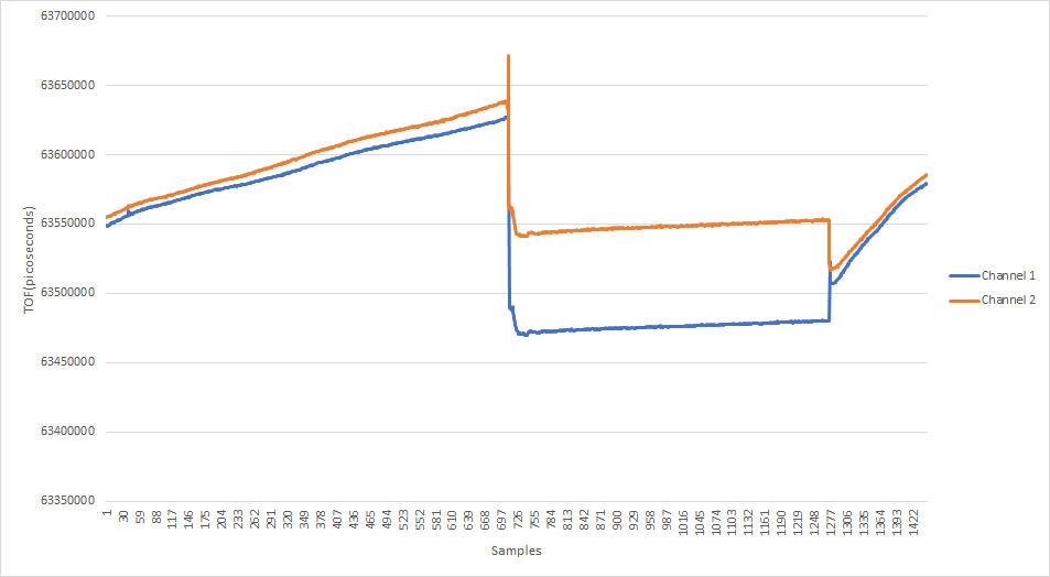

    I hope everything is fine. I tried your suggestion to manually swap channels and it worked like a charm. I have another problem when there is no flow my measurements increasing you can see plots below. What could be the cause of that increase when there is no flow? Thank you.
    In this plot I took zero flow first than constant flow and than again zero flow, as you can see zero flow measurements increases
    In below plot I changed the water flow revers thats why channel 1 and channel2 swapped places. This time I tried first constant flow than zero flow, as you can see zero flow measurements increasing zero flow measurement results not changed.

    I'd glad it's working better now. The constant flow TOF measurements look good.  Although the TDC1000 is known to have low accuracy in low and zero flow measurements, this behavior looks unusual, and I am not sure off hand what the cause would be. Comparing your first and second plots, it looks as if the TOF measurement continues to increase as more samples are collected (~700 in the first plot and ~130 samples in the second). What happens if you measure zero flow for a long duration?

    A few likely causes for the zero flow drift that we have seen are device inaccuracy, transducer mismatch, or physical variations such as temperature of the transducer or water temperature. For example, a temperature change as small as 0.4 degrees C could be responsible for the 50-70 ns drift. However, this inaccuracy at zero flow is a known weak point of the TDC1000. Here is an app note on hardware changes to mitigate the zero flow drift: SNIA020
    Additional data processing is also a good option in this case. Your data shows that although there is drift upwards during no flow, the difference in the upstream and downstream measurements is very small as expected, and the initial zero flow measurement before it starts to drift also looks good. I think you could use those two facts from the data to be able to always accurately detect when there is zero or very low flow.

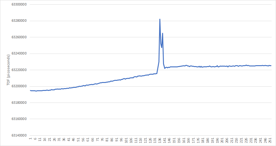

    I took zero flow measurements for a long time this is the plot I is continuously increasing. What can I do? Thank you.
  • Hi Murat,
    Please see my previous post for my suggestions on mitigating the effects from this. Could you specify the specific issue that this zero flow drift poses for your application?
