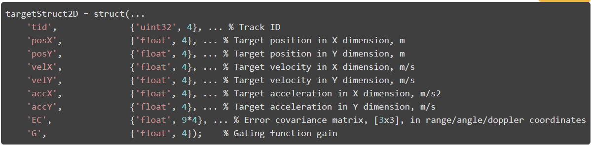

  • Hi Jake,
    Please refer to the resource pointed in the following thread.
    Compiler/IWR1642: how to parsing traffic monitring demo uart data
    Once you understand the above, you can also refer to the source of the Matlab visualizer provided in the demo as a reference example on how to parse the output stream.
    -Nitin

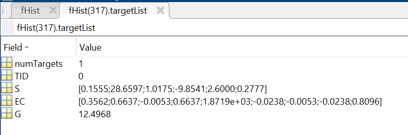

    I am still a little lost as to what the data represents within the targetlist in MATLAB, I understand that it should hold all of the information shown below?
    But I don't quite understand where the posX, posY, velX, velY, accX and accY data is? (below is an example of a target list from one of my fhirst files) does 'S' in the below image represent the position velocity and acceleration?
  • Jake,
    Are you using the Visualizer provided with the demo in the following directory or is the above a snapshot from your own parsing script?
    C:\ti\mmwave_industrial_toolbox_3_6_2\labs\lab0013_traffic_monitoring_16xx\gui\tm_demo.m
    The above script provides a complete parser implementation and you should be able to re-use / derive from it as needed. The parsing logic start at line 326 as shown below.

    Please first check that the demo works with the provided visualizer and use that as a reference for parsing / debugging.
    Note that we are not able to support / debug your own parsing code.
