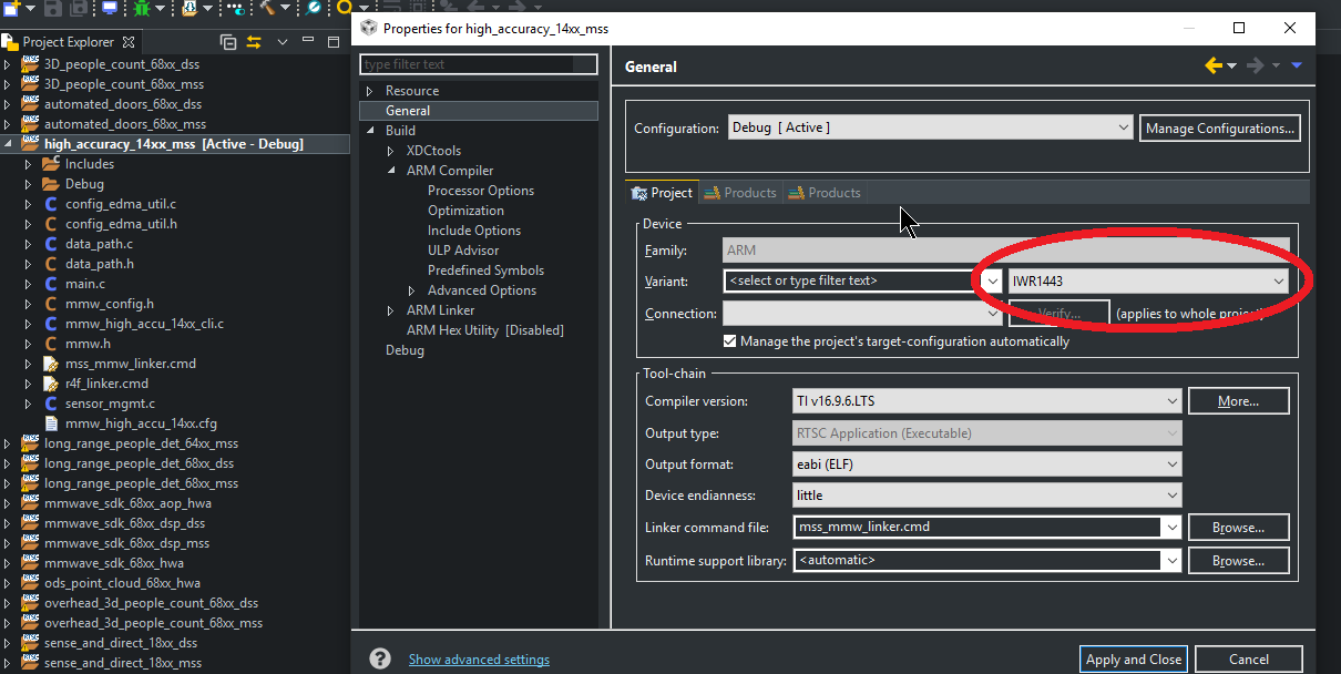

  • Hi Michael
    There are a couple of reasons why it is used. First is because there are device specific components such as memory size and location which the IDE can take into account and flag during compilation. Another reason as is used for this lab is the naming convention of the files allows the appropriate device specific config/driver/control files to be pulled/referenced from the SDK e.g. 68xx vs 14xx.
    Would you be able to post a screenshot of the errors you are seeing on compilation?
    Can you also confirm that your project files and project properties look similar to mine as posted below? This was taken after a clean import into the workspace and no compilation.

  • Hi Akash:
      Yes, I understand how MMWAVE_SDK_DEVICE is used and why it is needed, but I don't understand why it is not defined in the second copy of the project. I have compared everything I can think of between the two projects and I do not see any differences. Every time I try importing the original project into another workspace, MMWAVE_SDK_DEVICE is not resolved and I get compilation errors. I have tried this several times.
      You must keep in mind that my original version of the project was modified and is no longer the same as what you show because we had begun development. So, of course, everything does not match what you have. However, MMWAVE_SDK_DEVICE is still defined in that original project and it still builds. However, when I import it into another workspace (to move it to another directory), MMWAVE_SDK_DEVICE becomes undefined and the project no longer builds.
      Everything you show in the General window of your screen capture above is the same in my projects except for the compiler version.

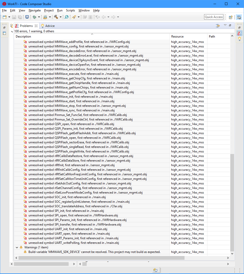

    Here is the diagnostic stating that MMWAVE_SDK_DEVICE can not be resolved.
    Here is the output from the compile. It is clear from the errors that MMWAVE_SDK_DEVICE is the problem.

  • Hi Michael
    Can you post a screenshot of the errors seen in the Problems pane when this occurs?
    Also are you saying this occurs with modified code and modified projectspec or clean code and clean projectspec in the new workspace? Please confirm and if there are any projectspec changes then please attach the file here.

  • Hi Akash:
      I did past a Problems screen capture into my prior response, but it appears it did not save. How can I insert a screen capture?

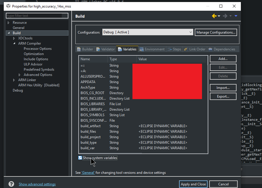

  • Hi Viktorija
    I’ve found how to enable compilation,
    One must go to Project Properties > Build > Variables and then enable Show system variables as in picture below.
    Then one must Add… the below variables,
    After doing this I am able to compile the project after previously not being able to do so.
