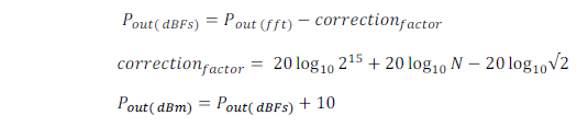

I want to convert the range FFT output to receive power dBm with IWR1642.
RadarStudio_matlab_scaling.pdf
With reference to these threads, I found that the following conversion formula could be used for calculation.
But I don't understand what Pout (fft) means in this formula.
Could you please tell me the formula to calculate Pout (fft)?
