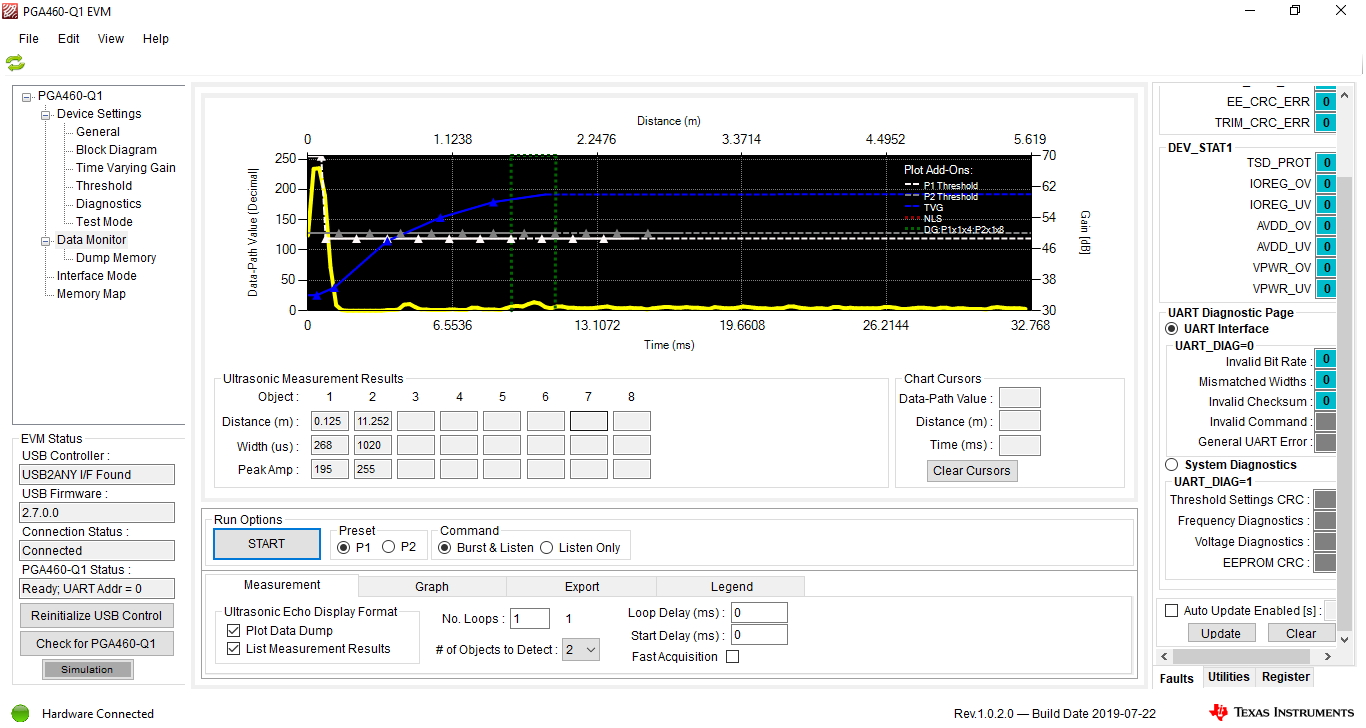

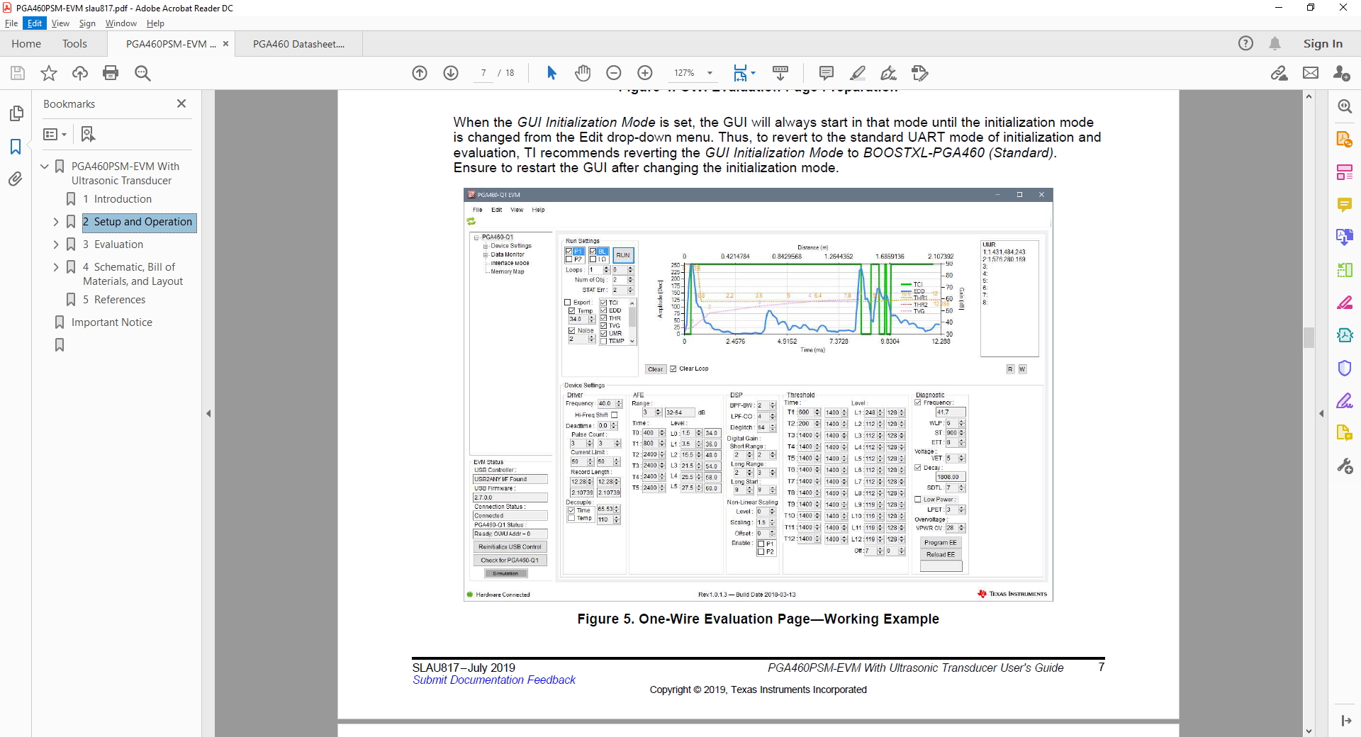

  • Mekre,
    Your last reply was very helpful in getting the GUI to work.  I was mislead by the MSP430F5529 LaunchPad's pins labeled TX & RX, they were not the correct UART pins.
    Now my problem is getting the PGA460-Q1 configured and optimized.  The second image below is the GUI configuration from the slau817.pdf.  The result after I configured the GUI and ran the test is shown below. My tage was at about 1.5m.  Since I recently bought the PGA460-Q1, I thought there should be an existing up-to-date configuration example.  Can you please run a test with the same parts I have and/or provide me with proper setup values so I can continue to evaluate and deploy this module?  I have customers ready to buy in the transportation industry if I can get this to work in a timely fashion.
    thanks in advance,
    Robert
  • Hi Robert,

    You can use these values as a starting point and then change values as necessary to optimize for your specific system and target. The following video series provides examples on configuring the GUI:
