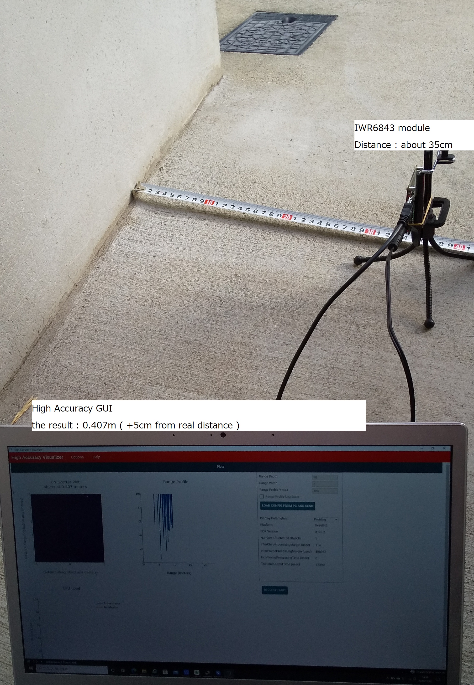

I test High Accuracy Demo using IWR1642BOOST.
When IWR1642 measured to ceiling, the result of measured value(from EVM to ceiling) and GUI monitor for Demo as below:
measured value : 193 cm
GUI monitor result : 2.0093 to 2.0097 ( about +7cm from measured value)
How calibrate the range measurement in High Accuracy Demo?
Please let us know procedure method.
