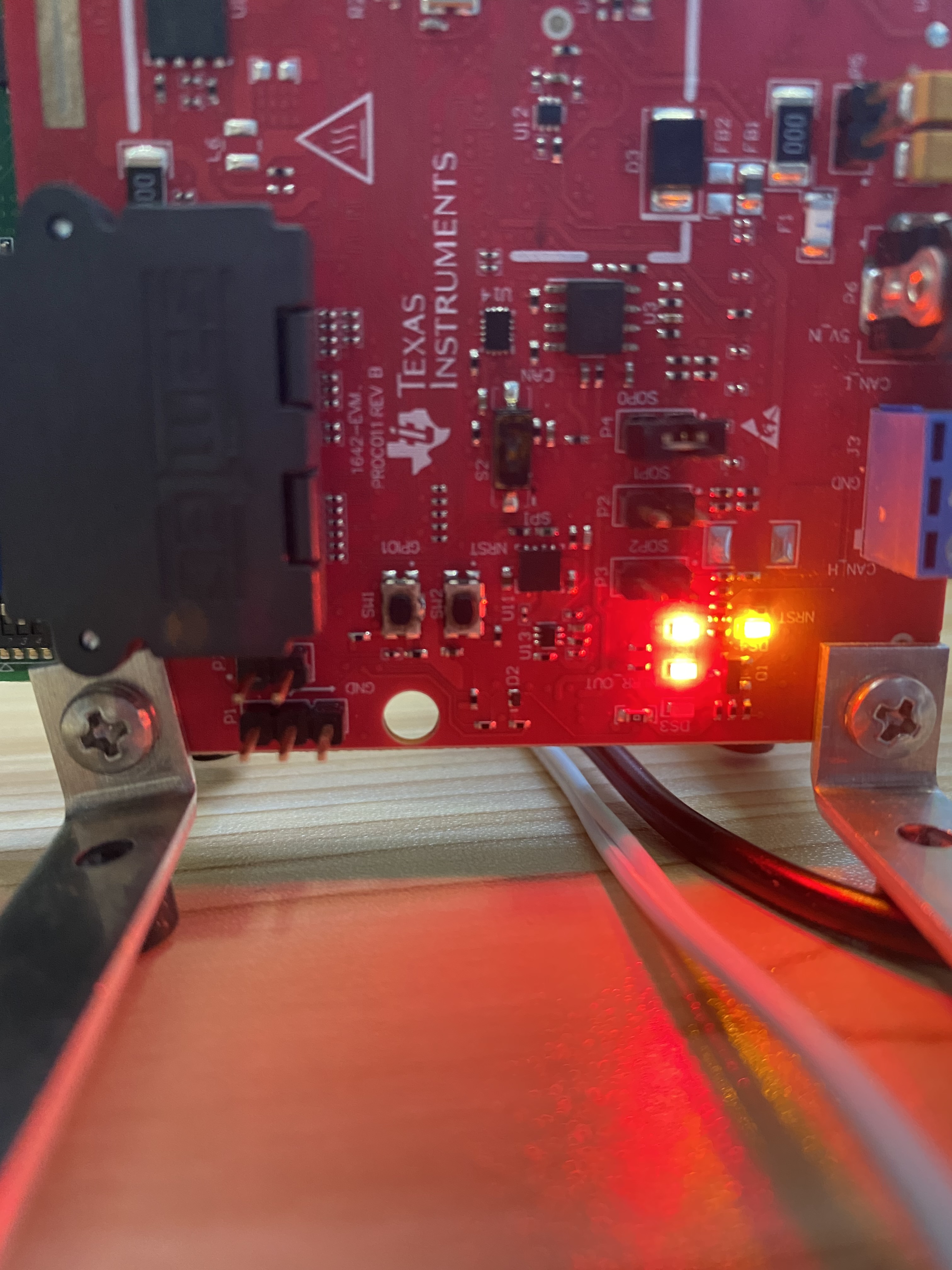

        • This is a physical picture of my hardware.
              He asked for SOP4 mode.

    This question is of great significance to my project. Is it possible that it is a hardware problem?I hope you can help me find the root of the problem. I really hope to hear from you again!
