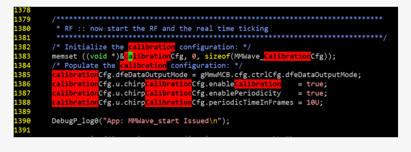

    Our software expert suggest to
    1) Try on SDK 03.04.00.03, if you see the same problem,  it is very likely that the calibration is causing the difference.
    2) On the new SDK version, try to disable the calibration by changing the calibration and periodicity to false in mss_main.c, and then recompile the code.
    Let me know how it goes.
    Zigang
    1. I tried with SDK 03.04.00.03, SNR captured using Demo Visualizer was 88.5dB
    2. I disabled the calibration in SDK 03.05.00.04 and compiled the code and flashed the binary, SNR captured using Demo Visualizer was 89dB.
    So, Change in Calibration is not causing any difference.
