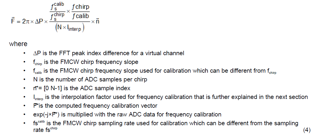

I have already read this question ''  https://e2e.ti.com/support/sensors/f/1023/t/924359?tisearch=e2e-quicksearch&keymatch=inter%20calibration  ''  and '' Imaging  Radar  Using Cascaded mmWave Sensor Reference Design '' in section 3.3 for related calibration. My question is:
the number of ADC samples per chip N and I_interp  (From blow picture) I set when collect data are different from the calibration's N and I_interp, can I still use the  "calibrateResults_high.mat" , or I should reset N and I_interp and collect  data again to form a new  "calibrateResults_high.mat".
