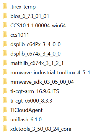

I have the following SW tool versions installed on my PC:

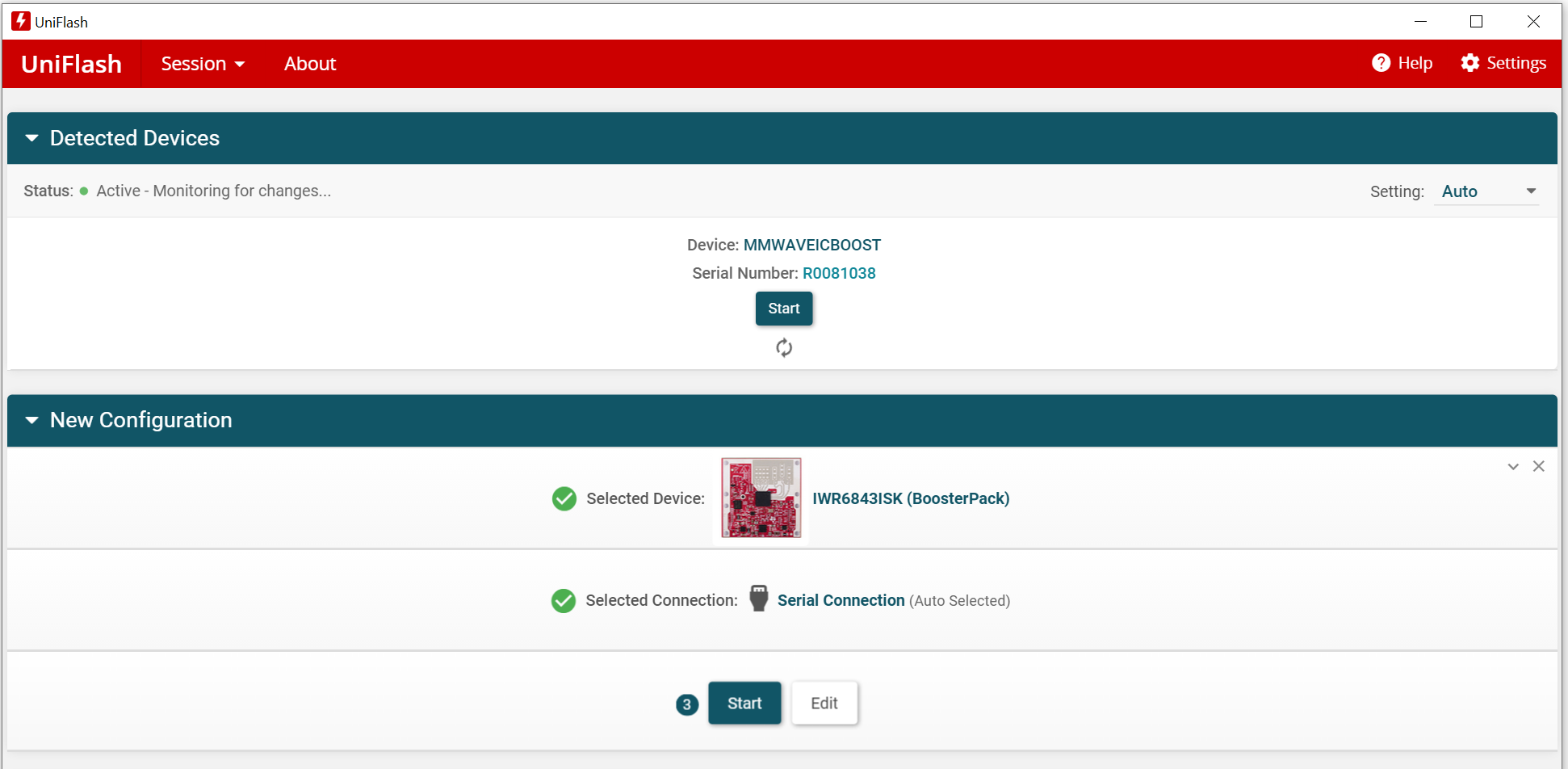

Starting UniFlash yields the following result:
MMWAVEICBOOST  is detected correctly but pressing start in the Detected Devices section doesn't do anything, however manually choosing IWR6843ISK (ODS version not available for selection?) works.

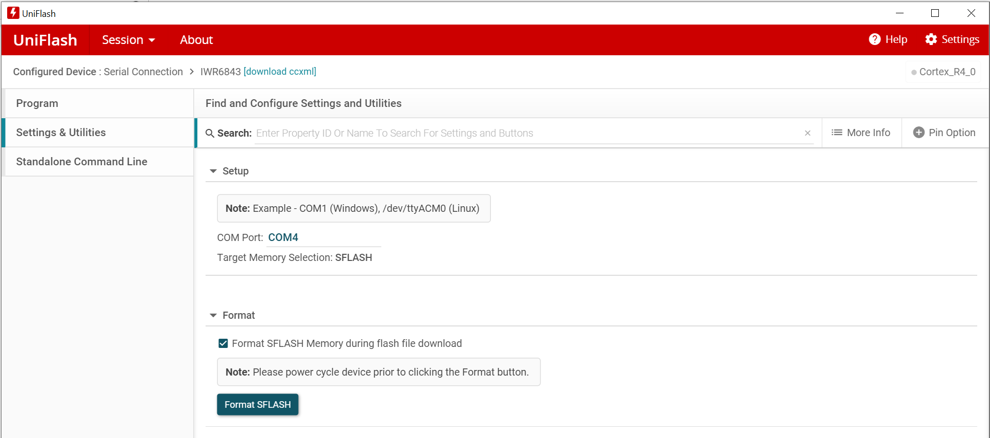

Next I set port to COM4 as per instructions:
