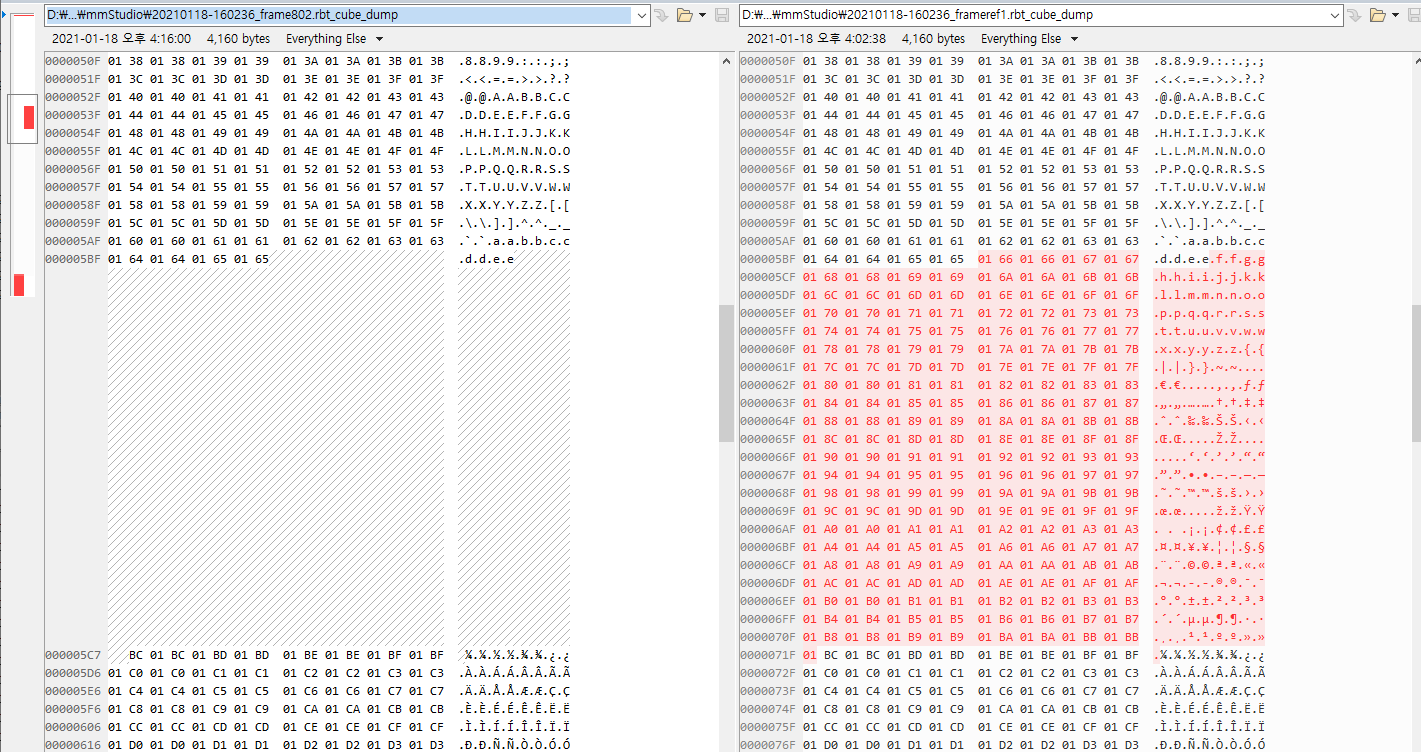

  • Dear Yogesh,
    i have checked with xds110 of mmwaveicboost.
    there is still problem missing data. (i think using xds110 is less than iwr6843isk only)
    following image shows that it was missing data at 802th-frame compare to 1st-frame.
    xds110's firmware is 3.0.0.14.
    thanks,
    hoyeon.
