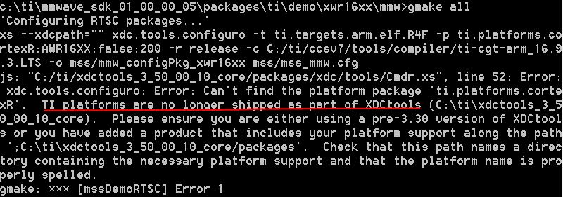

Hi All,
I want to build mmw demo in C:\ti\mmwave_sdk_01_00_00_05\packages\ti\demo\xwr16xx\mmw.
According to release note, i downloaded XDCtools from http://software-dl.ti.com/dsps/dsps_public_sw/sdo_sb/targetcontent/rtsc/3_50_00_10/index_FDS.html.
When making files, it reported there is no ti.platforms.contexR in this XDC core package. I think these targets files should be in the XDC tool standard version but NOT core version. Howerver, i can't find standard XDC tools in TI website.
Could you please help to tell me how to get these target files?
Thank you.
Allen

  • Allen,
    In XDCtools download page, download the installer that has no mention of JRE. After installation, the location is under C:/ti/xdctools_3_50_00_10_core
    Please let me know if you still have issue.
    Michelle
  • You're getting this error because you didn't configure the paths (BIOS_INSTALL_PATH) in set_env.bat to point to the correct directory.
    Any other errors are all caused because of this. Also, make sure to use the exact versions as mentioned in the user guide.
  • Hi Rakshit, Michelle,
    I think i set BIOS_INSTALL_PATH correctly. Here is my setenv_tools.bat.

    And i tried XDCtool with or without JRE version, there is NO target definition in these two package.
    Allen
  • Hi All,
    Sorry i forgot to execute mmwave_sdk_setupenv.bat after i modified setenv_tools.bat.
    Thank you for help.
    Allen
