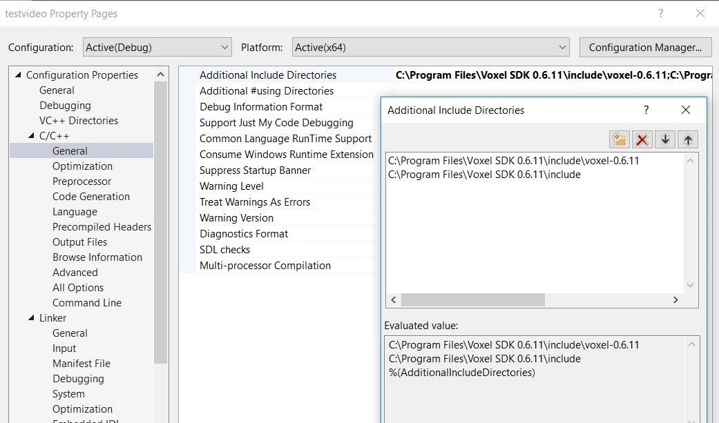

I tried to read RGB ToF and Depth cameras using Visual Studio 2017 C ++.
For RGB camera I use openCV.
I tried scanning the depth camera, but there were 0 devices detected.
I included my library setting, can be shown in the attached picture.
I have install:
- FvSdk 0.0.3-win64
- qt-opensource-windows-x86-msvc2013_64-5.4.0-rc
- pcl-1.7.2
I have put the path in the environment variables:
- C:\Program Files\Voxel SDK 0.6.11\bin
- C:\Program Files\Voxel SDK 0.6.11\lib
- C:\Program Files\Voxel SDK 0.6.11\lib\voxel
Is there something wrong with my code or settings?
This is my code:

  • Hi Wahyu,
    The path settings seem alright. Just make sure to include the path to the build as VOXEL_SDK_PATH.
    Are the device drivers installed? Please install voxel viewer from www.ti.com/.../sbac143. That will install the device drivers for OPT8241-CDK-EVM.
    If the EVM runs with Voxel Viewer, there's probably something wrong with the code.
    Suramya
