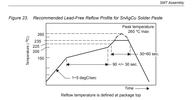

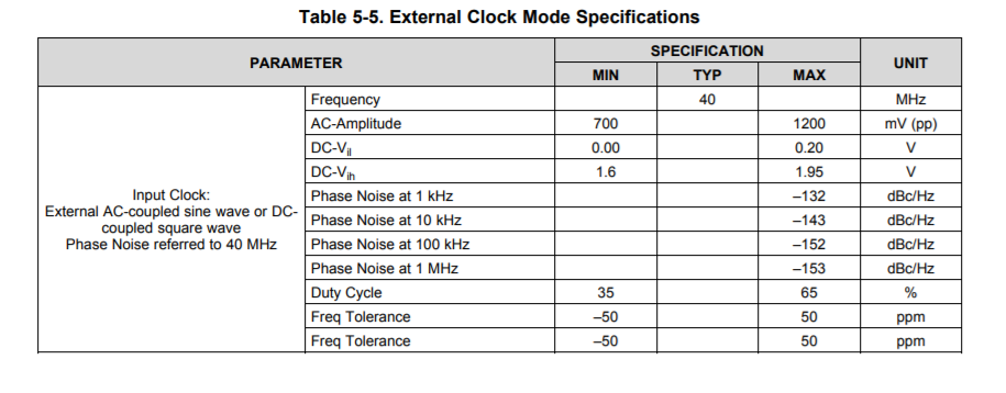

  • Hi expert:
     Question:  I want to know the reason for channel inconsistency.
        The test consistency of channels of different chips and different channels of chips is not good,
    The amplitude and phase are very different, and the range of amplitude changes is 15dB.
     What I have done : Confirm the antenna is good by testing,
                                      the chip works
    I doubt where the problem might arise:
        1、Channel inconsistency caused by chip;
        2、Channel inconsistency caused by impedance mismatch between chip and antenna;
    What I want to know:
        1、How to test and screen the chip, and whether to provide chip testing and screening methods;
        2、Can the impedance test report of chip pin be provided;
        3、Will the noise, oscillator phase noise and spurious introduced by the external 40m crystal oscillator? If there is noise, oscillator phase noise and spurious, will the performance be affected;
        4、Do  need to pay attention to chip welding? Will reflow soldering of SMT chip affect it;
        5、What should be paid attention to in chip pin connection and how to ensure consistency;
    Thanks for your attention and wish your help.

    3) 40 MHz uses crystal on the board, Yes we need to follow certain clock spec requirement as shown below. Also if you use external clock then there is a phase noise requirement that must be followed as this would be used as a reference clock to PLL/synthesizers.
    4) Yes, you need follow recommended guideline for the reflow soldering of SMT chip.
    Below is the recommended reflow profile for the solder paste.
    5) & 6)  For more details you could refer to "Flip Chip Ball Grid Array Package Reference Guide" in the below link.
    http://www.ti.com/lit/ug/spru811a/spru811a.pdf
