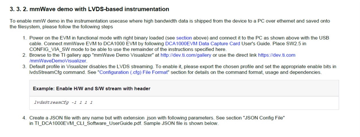

  • Wallace,
       Currently mmWave demo with LVDS-based instrumentation is supported through the SDK as shown below in the SDK userguide document
    Unfortunately, MRR demo is not available in the LVDS instrumentation.
    Source code of out of box demo could be found from the following location in the SDK
    C:\D\ti\mmwave_sdk_03_03_00_03\packages\ti\demo\

  • Hi Wallace,
    I am not sure we understand your goal and the question below.
    "In the reference code inside OOB Demo, only the detected points are sent. So it can not solve my problem."
    The Out of Box demo can stream out RAW ADC data as well as the detected points and each can be individually enabled using the options given in the lvdsStreamCfg command. If your goal is to capture raw ADC data, you should be able to do so without any limitation using the Out of Box demo using LVDS instrumentation process.
    -Nitin
