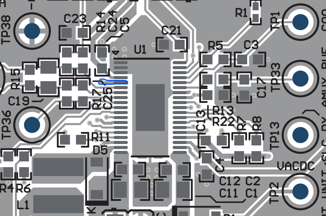

Dear TI team,
Just got the lovely TPS8804EVM.
Before doing the experiments, I have some question about the AGND pin and its layout .
1. Is AGND (pin 5) already internally connected to the DGND pin (pin32) and/or thermal pad and/or PGND pin (pin 17)?
2. Why in the layout of TPS8804EVM,  AGND pin externally connects to nothing but only an isolated place. (see belowed)
    Why can't this pin connect externally to the thermal pad? Or do I make any mistake?
3. In the Datasheet, AGND (pin 5) is described as "Analog ground. Connect to ground plane." Does this statement contradict to the layout of EVM board?
    (I've measured that there is no significant resistance between this isolated AGND plane and other ground plane.)
(Top side of the board)
(Bottom side of the board)
Looks like that at least the AGND Pin is internally connected to the thermal pad.
And I am not sure about why the pin 4 is left in an isolated plane externally.
Thanks for reading this post, and hope someone will answer my question.
