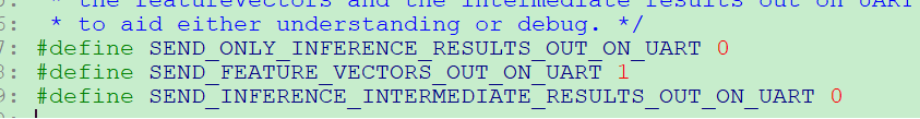

Hi Team
I am using multiple gesture and motion detection demo of iwr6843. The toolbox is  mmwave_industrial_toolbox_4_4_1 .
in the mss_data_path.h: #define SEND_FEATURE_VECTORS_OUT_ON_UART  1
in the dss_main.c : MmwDemo_dssSendProcessOutputToMSS ,I modified as follows:(blue )

 mss_main.c :MmwDemo_mboxReadTask (),send feature vector to uart
#if SEND_FEATURE_VECTORS_OUT_ON_UART
                /* Send the  feature vectors. */
                UART_writePolling(gMmwMssMCB.loggingUartHandle,
                    (uint8_t*)SOC_translateAddress(message.body.detObj.tlv[0].address,
                        SOC_TranslateAddr_Dir_FROM_OTHER_CPU, NULL),
                    message.body.detObj.tlv[0].length);
#endif

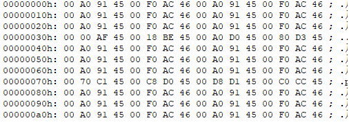

But I received the data as shown below, not 0x1234 and 0x5678, can you help me explain the reason?
Because we want to send the feature vector to the pc and send it to the neural network for processing,
so enable SEND_FEATURE_VECTORS_OUT_ON_UART ,then we found  the data received by uart is not right;
    You will need to synchronize to the message header using the magic word as shown below, skip the header and then reach the actual data buffer. So first look for the header workds inj the output packet (i.e. the platform ID and magic word) to parse the header.

    I think the address of feature vector is : (uint8_t*)SOC_translateAddress(message.body.detObj.tlv[0].address,
    so there is no need to skip the header and then reach the actual data buffer.Is this correct?
  • Yes, that is correct. But you still need to find the magic word "1234" sent by the DSS to synchronize to the output structure:
